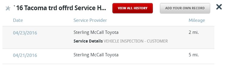

    I'm a bit late to this thread.. but as many other threads and posts raised concerns, I asked the dealer to perform the following things before I took delivery:
    - ATF level / top off
    - rear diff fluid level / top off
    - u-bolt on rear axle torqued properly
    - grease the zerks
    The dealer's service department gave me one of those reports you get when you get a service listing what was done.. but I'm a bit suspicious (like i should be). The service report basically had my words from my e-mail to the dealer copied.... looked almost like a ctrl+c then ctrl+v... The reason why I say this is because usually in service reports, I see things itemized into line items... in the report they gave me. it was just a paragraph of (almost exactly) my words in my email...
    I registered to the Toyota owner's site, and this is what shows for the service record for my truck's VIN. "Service Details: Vehicle Inspection - Customer".... Is this supposed to show things that were checked / performed itemized in detail?
    Should I go back to the dealer and have them check in front of my eyes? Or should I just call corporate? I'm not feeling / experiencing any weird transmission behavior, but I think I saw the OP warn that even if the transmission isn't showing any symptoms, ATF could still be low...
