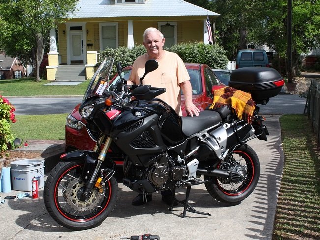

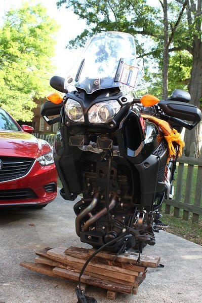

    I was a bit apprehensive about the procedure until my girlfriend pointed out I'd removed $3,000+ worth of motorcycle parts just to grease two tapered roller bearings on my Yamaha. LOL Checking it yourself is a bit fiddly. But, doable in a few minutes with the help of a spotter on the dash display. Unless you buy a bottle of WS ATF, it doesn't cost anything more than a little dirty laundry from crawling under the truck. :)
    Yamaha XTZ12BB Super Tenere, a.k.a. Shawn the Sheep.
    Professional mechanic buddy Dan Roark
    giving his smile of approval upon reassembly.
