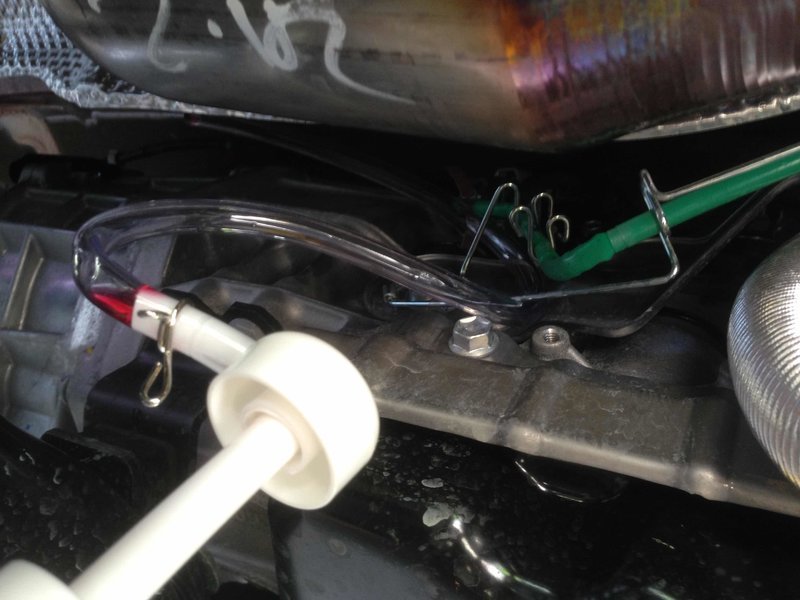

    I'm going to check my fluid this weekend, does anyone have a picture of the overflow bolt? I see the fill plug, I don't want to screw this up. Thanks

    Added about half a quart and unplugged the battery to reset it. I can't believe the difference in how it feels. It's like a different truck

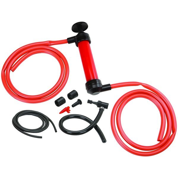

    If anyone's interested in not repeating the mistake I made:
    Harbor Freight stores have the same Pittsburg Automotive transfer pump as O'Reilly's Auto Parts.
    I paid $17 and change for it at O'Reilly's. Today, I saw the same, exact one at Harbor Freight for $6.99.
    It's a good pump & moved a full quart of ATF very quickly.
    It doesn't screw onto a bottle like the smaller, low-capacity pumps, though.
    First, I removed the cap from the ATF bottle, then I took a pocket knife and cut an "X" in the cap
    and pushed the pickup hose into the X-shaped hole. The plastic "gasket" under the cap popped free when I did. So, I put it aside for later.
    I propped the ATF bottle up in a small, square bucket using what I had on hand - six boxes of .40S&W ammo sealed inside two 1 gallon Ziploc bags.
    Go ahead and laugh. I couldn't find two bricks when I needed 'em. :)
    Done topping off the transmission, I removed the pickup tube from the bottle very gently to allow what was remaining in the tube to run back into the bottle.
    Then I put the gasket from earlier back inside the cap and sealed the bottle up again.
