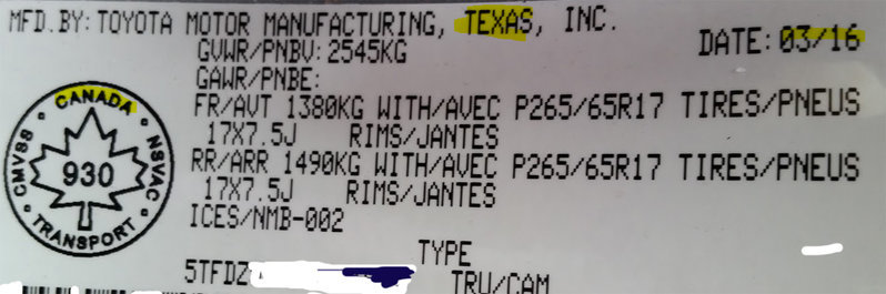

  16. Jun 8, 2016 at 5:22 AM

    This information is written on the truck body?

    ok... I open my eyes.... o_O
    Transport Canada Tag in the driver door
