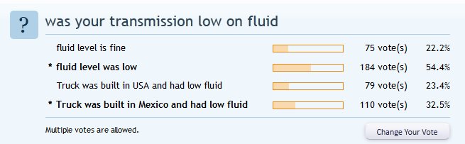

    I've been struggling with the results of the poll.
    Either a respondent had low fluid, or they didn't. So line 1 and 2 should add up to 100%.
    If lines 3 and 4 are intended to be a breakdown of where the low fluid trucks were built, then they should also add up to 100%. If they are supposed to compare the number of "trucks built in the US with low fluid" with "trucks built in the US with normal fluid", well, that's a different question.
    The overall picture is clear, lots of trucks were low, but due to the fact that up to two choices are allowed in the poll (some low fluid respondents may have checked line 2 only, some may have checked line 3 or 4 only, and some may have checked lines 2 and 3 or 4), the actual values become skewed.
  9. Jul 11, 2016 at 4:21 PM
    #689
    Nitori
    Nitori Well-Known Member
    May 3, 2016
    #186058
    4,897
    Maricopa AZ
    2021 T4R SR5
    Well, 3 and 4 add up to 189 which is roughly equal to 184, so I think most people got the idea and checked 2 and then 3 or 4. Looks like only 5 people went straight to 3 or 4 without checking 2.
    So out of 264 assumed respondents 189 were low, 75 were ok. That's 71.6% low, 28.4% properly filled. Not good!:eek:
    Breaking the Tejas vs Mehico deal, that's 189 total votes. 110 were Mexican built, 58.2%, and 79 were US built, 41.8%. So roughly half and half but slightly favoring US built to be properly filled.
    (I agree it kinda is annoying how the poll chalks up results but it's trying to track all 4 as separate responses... think "red, blue, green, and yellow" as being responses, not "blue, and if it was red, was it dark red or light red")
    ======WARNING STATISTICS CONTENT BELOW======WARNING SERIOUSLY NERDY SHIT BELOW===============
    So we've got a sort of conundrum here. Our sample size is actually large enough to be statistically significant and reasonably accurate, assuming a population of 95,000 trucks (I'm taking this number from YTD sales as of the end of June).
    Assuming a 95% confidence level and a 6% confidence interval (that is, plus or minus 6% of all Tacos having low fluid or not) we would need a sample size of 266 for statistical significance. We've got 264, which is close enough.
    With this sample you could conclude that roughly speaking, somewhere between 77% and 65% of trucks out there are low on fluid. That's bad, real bad. The relative even split between US and Mexico makes me think it's a process control issue, not a certain factory.
    I'm a bit reluctant though to preach this as gospel because we do have a definite sampling bias. I had my fluid checked because of what I saw on here- I had no symptoms, and my fluid was properly filled. What we don't know is whether respondents were symptomatic (had rough shifting) or asymptomatic (only got it checked because of reading TW). This sort of deep sixes any good statistical analysis.

    4 people left I changed my vote ... Added my check in 2 ... Apologies to the above posters for making u guys think lol

    WHOA! That's friggen awesome!
    Analysis and explanation, good kind of awesome. Results, bad kind of awesome.

    The statistics may not be purely scientific but they are representative enough to show beyond a fact Toyota has a quality problem when building their trucks at both their plants in Mexico and the USA. Now the question is how long it will take them to listen to acknowledge the facts from their buyers and react in a decisive positive manner? W
    We are listening and waiting Toyota the more you delay the more present and future sales you loose!

    Some excellent analogies here lol .
    Its my fault .....When I started the poll , all I had listed was if your truck was low on fluid or not .
    A few months later while we were trying to determine what factory was causing the low fluid issue , we added the manufacturer,s location in an effort to determine if one of the two factories was the root cause .
    As you can see now , its clear that both plants are still sending trucks to dealerships low on fluid with build dates in June of 2016 .
    They know about the problem but refuse to rectify it at the factory level ?????????????????
