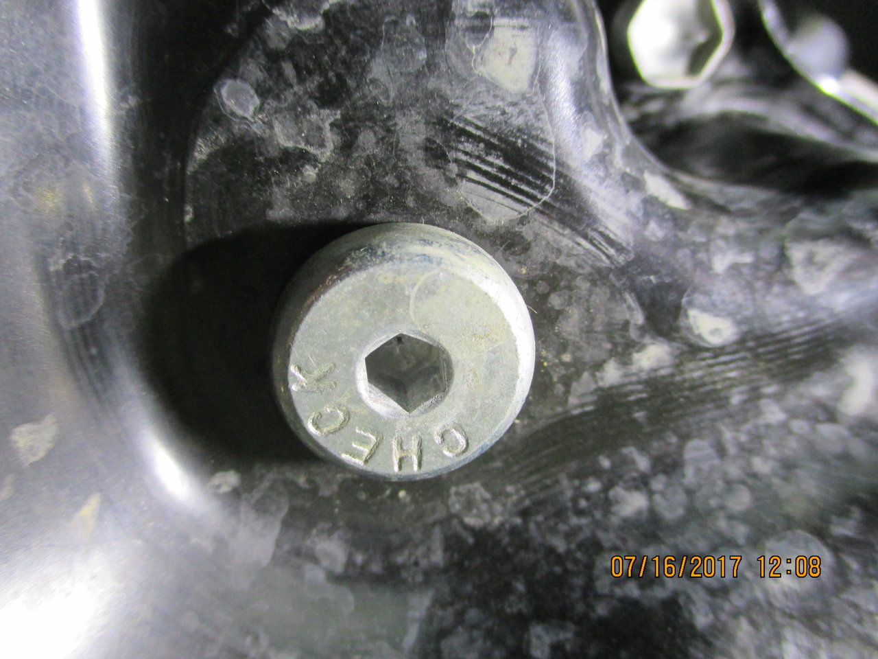

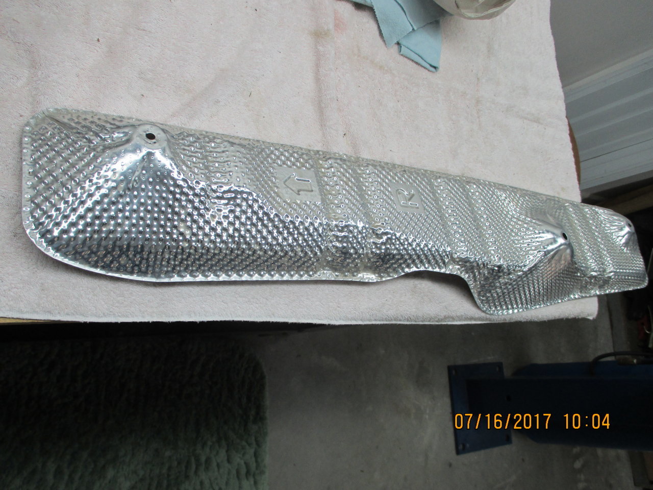

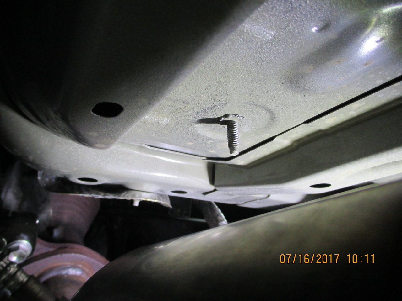

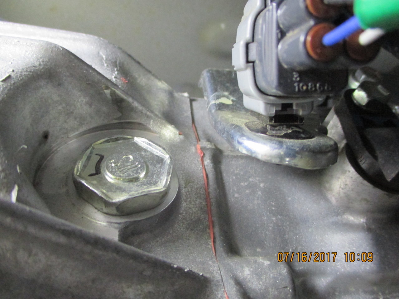

    Thanks again to Gearcruncher for your hard work. I've read the entire thread on low trans fluid, and now that I am aware of this issue I am going to get to work. First a call to Toyota Corporate. I'm going to wait and see what they say before I do my own check on the fluid level. Hopefully the selling dealer will be cooperative?
    Yesterday I had my truck up on my drive on lift. I took the time to R&R the heat shield and de-burr the edge. Three 10 mm nuts and off it comes. Much more room to see and work.
    While it was off I took these snaps. I hope that that will clarify for others where the plugs are.
    I know it has been addressed some but, it seems to me that a infrared thermometer would save a hassle, and using a second person in the truck to report the temperature range. The pan temp and the fluid temp can't be that different, time wise. So I'll pin it, measure the temp, and add until it pukes a little. That's what I plan to do unless I get dealer support.
    Any body see a disaster with this?
    Also my u-bolts were not very tight. I didn't measure but they were around 35 ft. pds. I took them up to 55.
    The rear and front diff's were OK with the fluid.
    I've already greased the drive zerks several times.
    Charles
