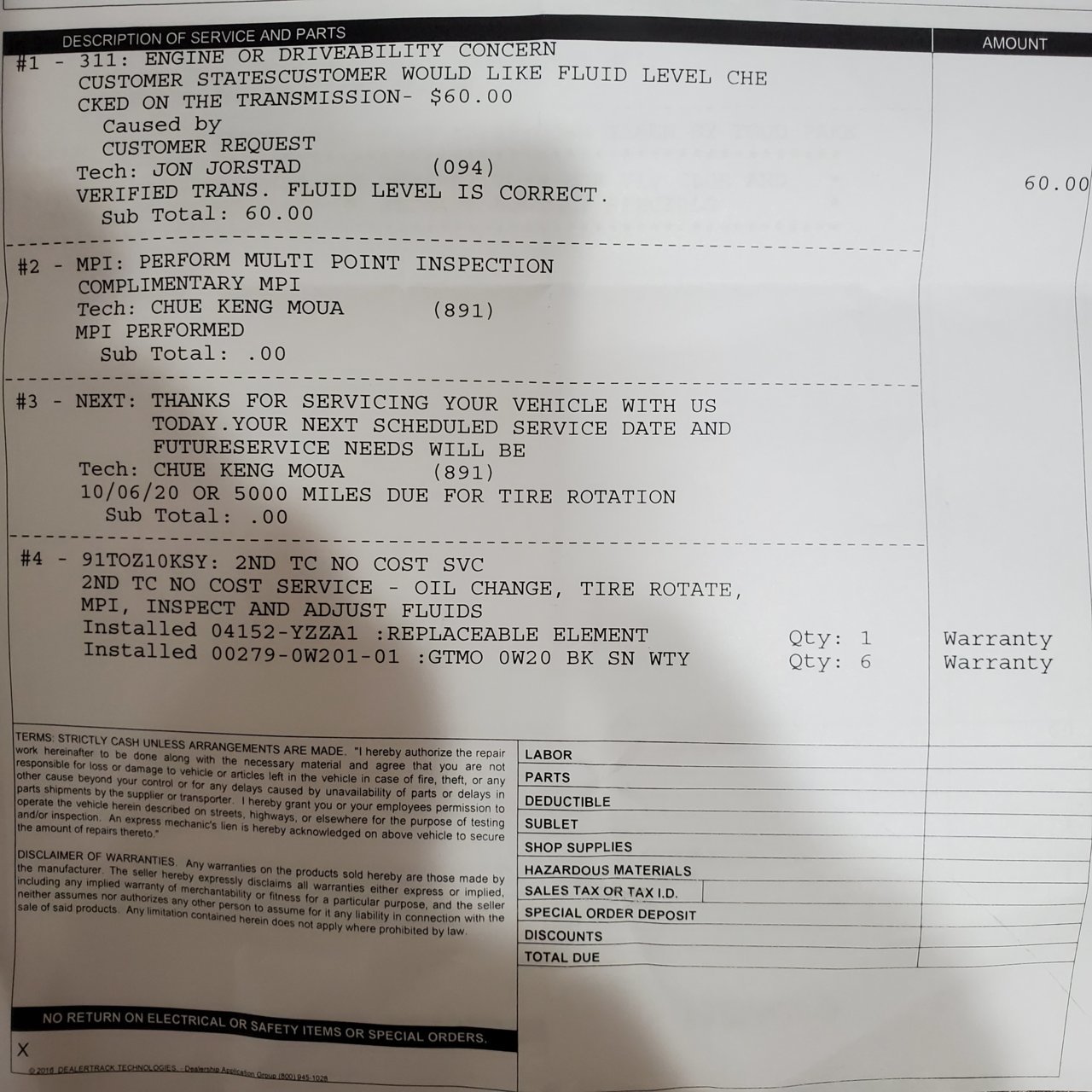

    Is that what they told you or did you observe that check of fluids. My service clerk was pretty much like yeah whatever we'll check it. But the afterwards receipt said nothing of it on there. Did this cost you extra to have this done and how much time did it take. Also did they actually put the procedure on the receipt?

    The Invoice states " Customer requests to check Transmission Fluid Level"
    Cause: Customer request transmission fluid level check, tech verified fluid level is correct, performed road test and health check 366991 tech verified fluid level in transmission correct, test drove and performed health check

    He told me it would be $60 to run the check, I would guess that's just the shop cost. He said if it was low they would look into extension or warranty and hopefully I get my 60$ back. Better safe than sorry 50k miles down the road.

    So I did get charged $60 for the check on fluid, but it was all good so it's fine with me. At least there is documentation so if it ever is a problem it's on file.

    On the bill of materials, are they only listing their time or does it also show fluid, crush washer, time for checking... etc? There is no level indicator that I have seen (maybe a pressure transducer in valve body) so to check level, someone would have to warm things up and crack the level plug. If you crawl under, you should see if they had cleaned up the tranny pan in the level bolt. So in your case, do you see if they actually checked if the level was correct based on the pan?

    This is all I got.
