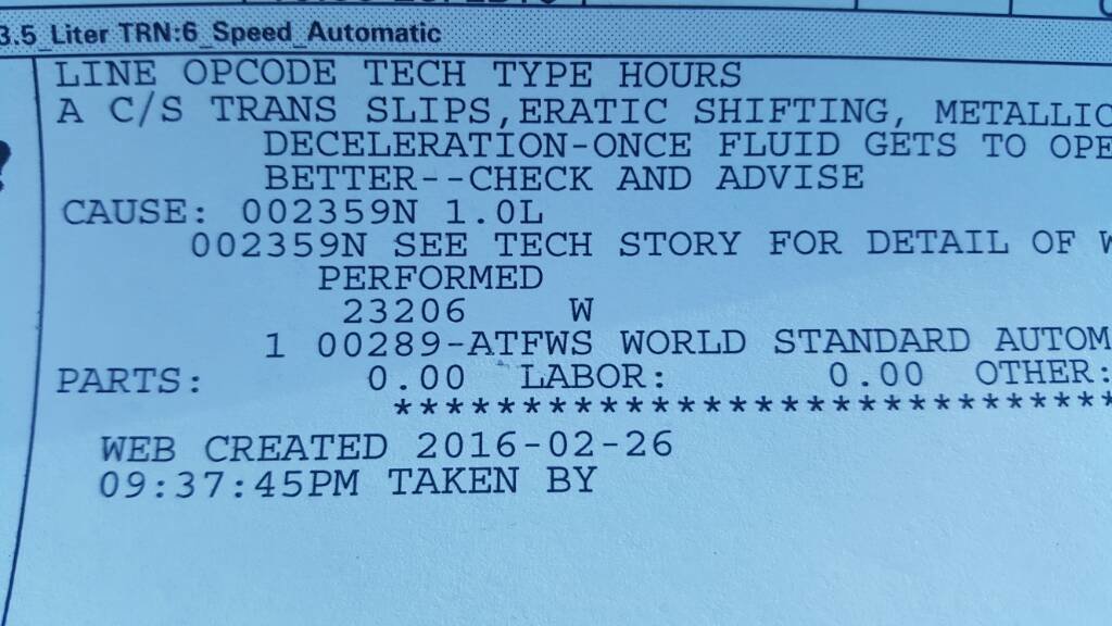

    Had mine looked at and checked by a certified Toyota tech at the dealer today whom I honestly believe was being truthful when he said the fluid level was actually slightly overfilled. Is it possible he checked wrong? Maybe. All I know is that my trans is slow to engage on a cold block when going from reverse to drive.
    Im in a bit of a pickle.

    A quart low they said. Vin starts with 3

    I am going to bet you a case of internet beer that your transmission is still low .
    With this said , you dont have many miles built up on your transmission and chances of damage are lower than most members .
    Call corporate first , then print out the proper procedure so you know the technician is following the 2016 fill guideline by the book , then re -schedule an appointment where you can leave your truck for a cold morning fluid check .
    As honest as the technician was that checked your fluid the first time , I do not believe the procedure was done properly

    I just got mine back from the dealer. They would not do the check until they verified the slipping. I left it for 4 days and they gave me a loaner (2016 Tundra 1794 Edition - very nice). It sat outside over the weekend and it's been in the 30s yesterday and today. When they checked it today they felt the slip and verified the low fluid level and adjusted it. Here is what the owners portal says about the repair.
    TRANSMISSION FLUID ADJUSTMENT ~|~CUSTOMER STATES WHEN GOING UP HILL FEELS TRANSMISSION SLIP, RPMS JUMP AND DOES NOT MOVE UNTIL A FEW SECONDS LATER, DELAY SHIFT. MOSTLY WHEN ITS COLD. CHECK AND ADVISE ~|~CUSTOMER COMPLAINT HARD SHIFTING DUPLICATED CONCERN, FOUND LOW TRANSMISSION FLUID. ADJUSTED TRANSMISSION FLUID, NO FURTHER PROBLEMS

    I park in a garage at work. Concrete parking garages are the coldest place on earth. I've felt it after the workday when leaving and driving uphill on the parking deck. I'll see tomorrow. Mine never felt a delay going from R to D.

    Just fired mine up 30mins ago after fluid adjustment yesterday. No more clunk and noticeably better shift performance.
