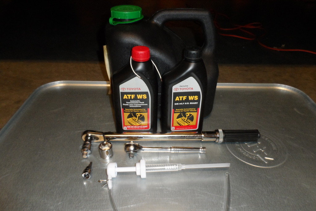

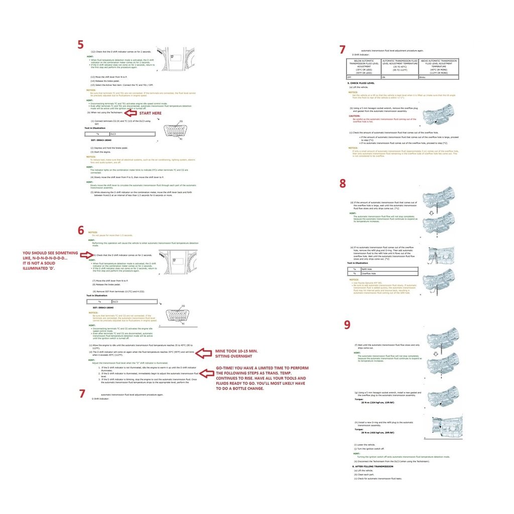

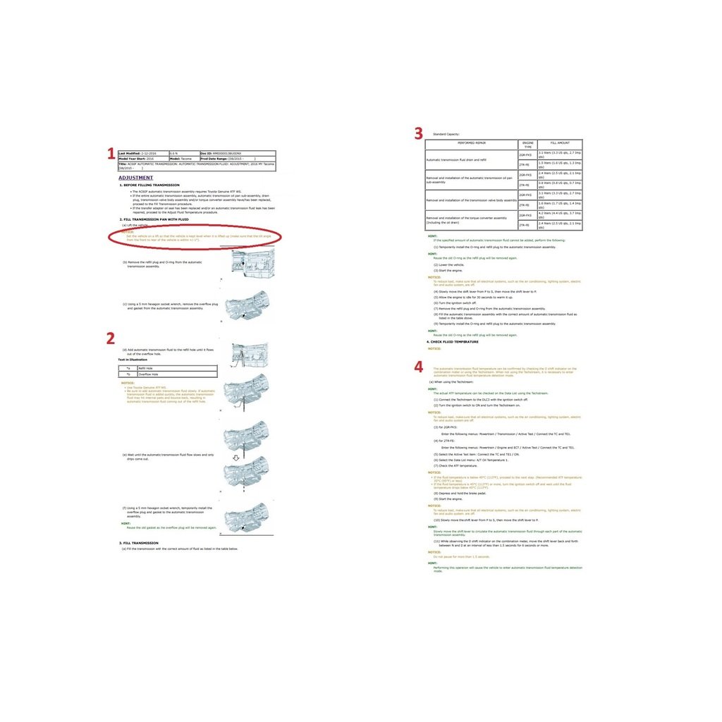

    Here's a link to the AC60F pdf.
    https://www.google.com/url?sa=t&rct=j&q=&esrc=s&source=web&cd=2&cad=rja&uact=8&ved=0ahUKEwjNyNHOla_LAhXCuIMKHagxAqAQFggiMAE&url=https://www.tacomaworld.com/attachments/ac60f_-automatic_transmission-fluid_-adjustment_2016-pdf.920122/&usg=AFQjCNG4ftETczFprsbtl-fxHbAPD5HGpA
    Put some notes in for the newbs.
    Things I used;
    -2 quarts Toyota ATF-WS
    -18 gauge insulated solid wire
    -3/8" ratchet
    -15/16" socket for fill plug
    -5mm hex drive for check plug
    -3/8" torque wrench w/ extension to re-torque fill plug
    -fluid pump
    -fluid container
    -microfiber rags
    64strings, alf and gearcruncher[OP] like this.
