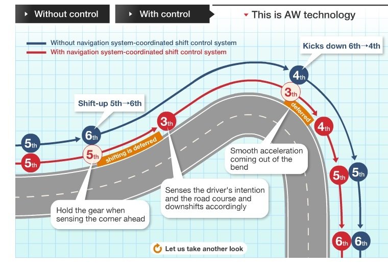

    Hey Split .
    Yes , Toyota uses ITS technology . Not all of it is used in the new Tacoma,s but pretty close .
    When we remove our foot from the accelerator pedal , the injectors turn off and the truck slows down . Programming in the pcm tells the transmission to downshift whenever you take your foot off the gas
  7. Mar 8, 2016 at 5:16 PM
    #147
    splitbolt
    splitbolt Voodoo Witch Doctor
    Mar 7, 2010
    #32761
    7,858
    NW Arkansas
    2016 TRD OFFROAD DCSB MGM
    Oops. Looks my link was no good.
    No. The tech I was reading about, uses navigation-GPS info to help control the transmission.
