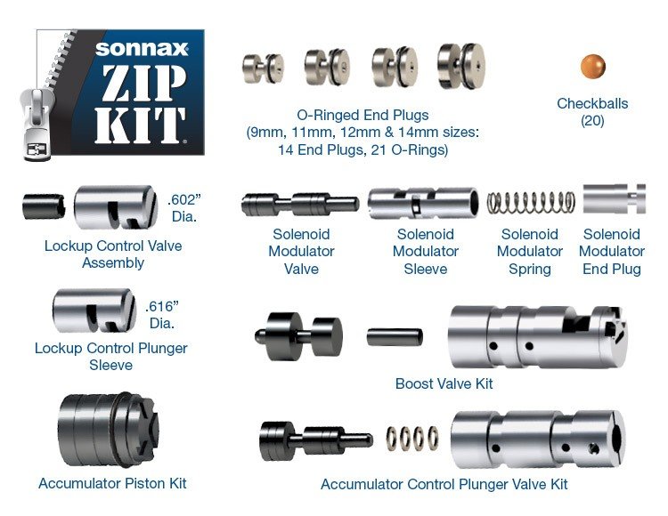

    I read through your linked page at the Sonnax site. Identified a worn lockup control plunger valve as the main cause of my RPM surge issue. Sonnax includes this in their Zip Kit. Because I'm planning to have RatioTek springs put in, I'll be going with a new OEM valve and sleeve to ensure overall compatibility. If you think I should replace any other parts in the valve body let me know.

    Thanks gearcruncher. Since @Locoluna825 is having similar issues, your advice is gonna get around.
    The RPM surges occur when the transmission downshifts while I'm coasting. As the tach needle falls to just above 1000 RPM I'll see a sudden drop to 500 RPM, followed by a quick spike to 1300 RPM, and then a slower drop below 1000 RPM where it settles down. This is without touching the gas pedal. Sometimes the needle ricochets wildly, other times it does a lazy bounce. Braking hides the problem.
    I started to suspect engine-related factors when I was writing my first post here. After reviewing the records, I know the throttle body hasn't been cleaned in 69K miles and the spark plugs haven't been changed in over 70K miles. Might as well plan to get those 2 things done ASAP. Hadn't thought of it earlier because the truck was running pretty well and hasn't thrown any codes.
