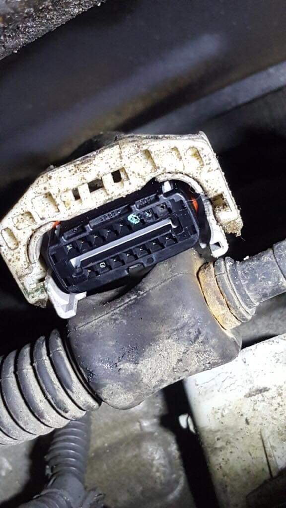

    Hey thanks

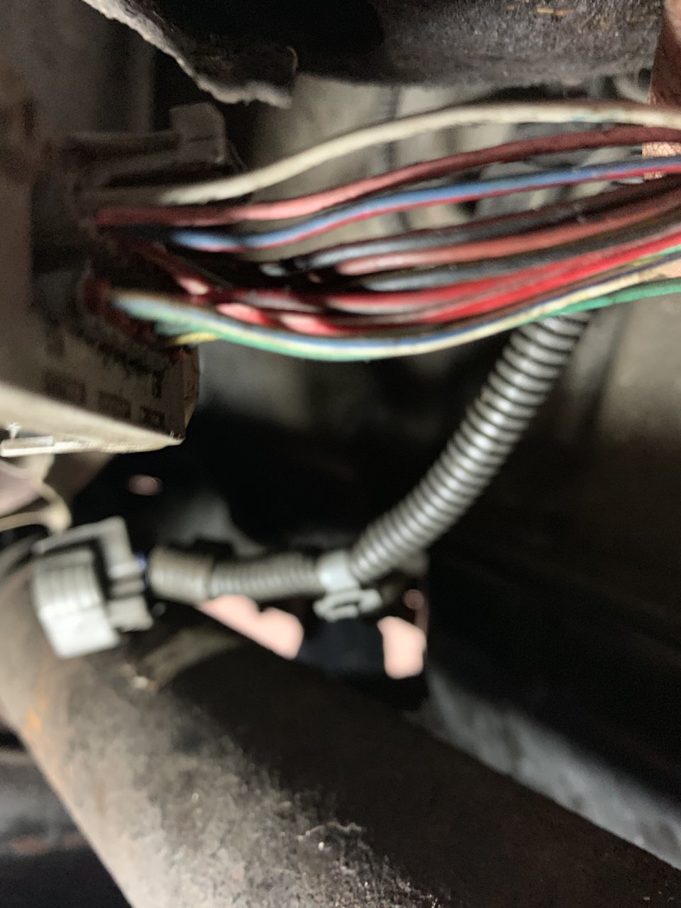

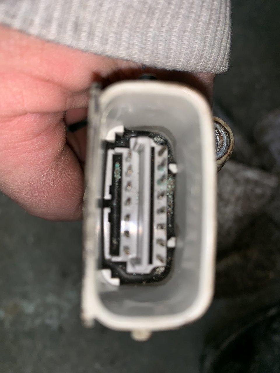

    I already changed the harness in the transmission
    i remove all the pins in tha female connector and none were broken i had some corosion on some
    I cleaned them with a welding tip and remove corosion on the pins itself i had voltage going true cant remember how much tho

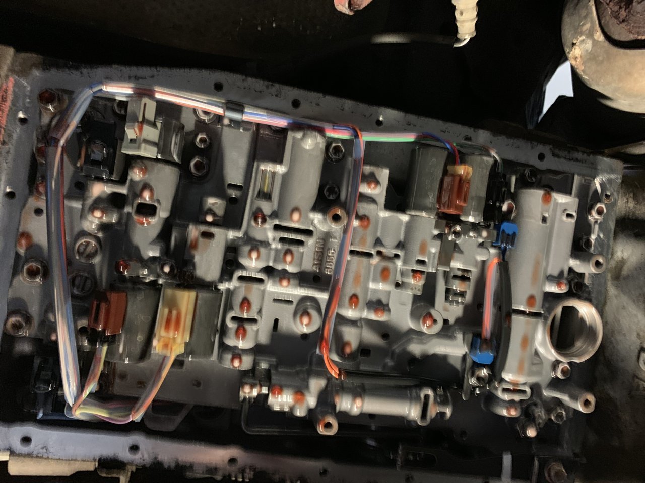

    I removed my pan again to check that sr solonoid and send 12 volts to it and it was making a working sound and could see the moving part work
    After i did all this i took it out and filled it like it supose too with AT temp thing
    I cleared the Po986 code took it for a spin it looked okay was shifting maybe for 10 min then boom check engine came back no more shifting in 5th
    I got
    Back to she shop now i had p0986 and p0771
    When i 1 got this p0986 i got it too toyota to check it out and they told
    Me i had corosion on that female
    Plug and resitance was not
    Good so they decided to start by changing harness on valve body so i got it in and when the tech saw a bit of metal shaving they told me my tranny was blown and was gona cost me lots $$$ i
    Told them to pit it outside i was gona fix myself i didnt buy that
    So here i am
    Tranny has 200000
    This saturday i want to recheck resitance on all the wires on that e5 plug on that ecm ... enything else i should look for ..2201AF03-8BDB-4974-81E6-1DBDCFCC3A58.jpgF0842676-6F07-4ACE-BE4B-52BEC80F8D46.jpg

    Sure is a lot of green death on those terminals .
    You will get a harsh engagement if there are codes . You need to remove battery posts when working on the truck , then re-connect when finished cleaning the wiring

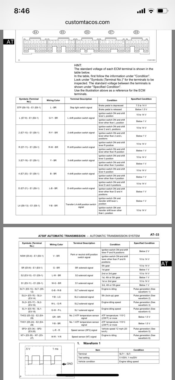

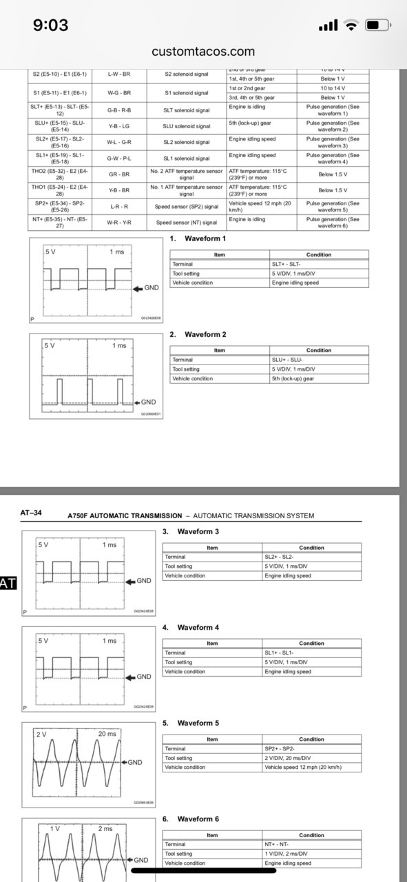

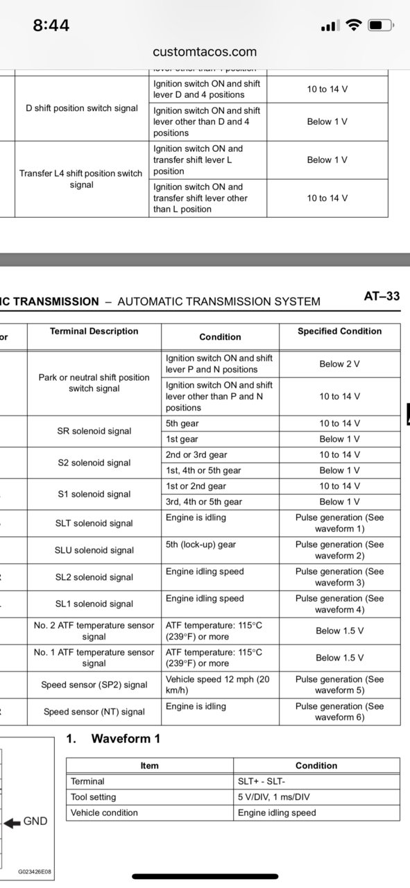

    963ED7A5-2BBB-4559-A982-61C0C91767A8.jpg 0774E23F-6DC3-425F-9291-2E4DF3E3E665.jpg When im checking from the ecm e5 plug
    Say the sr solonoid which is E5 plug and pin number 9 do i need to check also the E6-1 pin also why is their 2
    And do i need to put the selector gear in drive when testing this to match that 5th gear
    When it says engine idling do i need to start the truck ?
    Or i just unplug the baterie and check just for the 10 volts ignition off for all of them for these test i think i need to let the baterie connected right because of the volts
    I dont understand the waveform thing also
    Between the number were it says e1 is that electronic circuit 1
    Also why here its say to test in volts and on other pages i found its says 11 too 15 ohms
    Sorry for my english im french and
    also a carpenter not a mechanic :) since i purchase this runner i had never work this much on my own reparing things
    Thanks again for the infos

    If you are testing for voltage you leave the battery connected and just test 1 wire . Ground your volt meter to the engine block .
    If you are testing the shift solenoid for resistance , you backprobe both wires with your ohm meter and battery disconected or key off

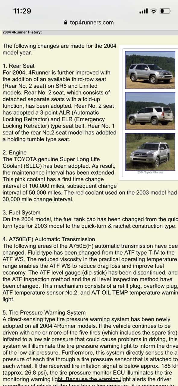

    It says here i have the 5 spd a750E(f) ?

    I also checked the 340 transmission and mine isnt like thisDFE7D857-57CD-4E8C-8F7F-3BA2C399F551.jpg
    This is mine

    You can see the difference also just by the oil strainer

    Yes , I always assume everyone owns a Tacoma because Tacoma World . These transmissions can also be found in the Tundra

    So im okay then on were i did my research
