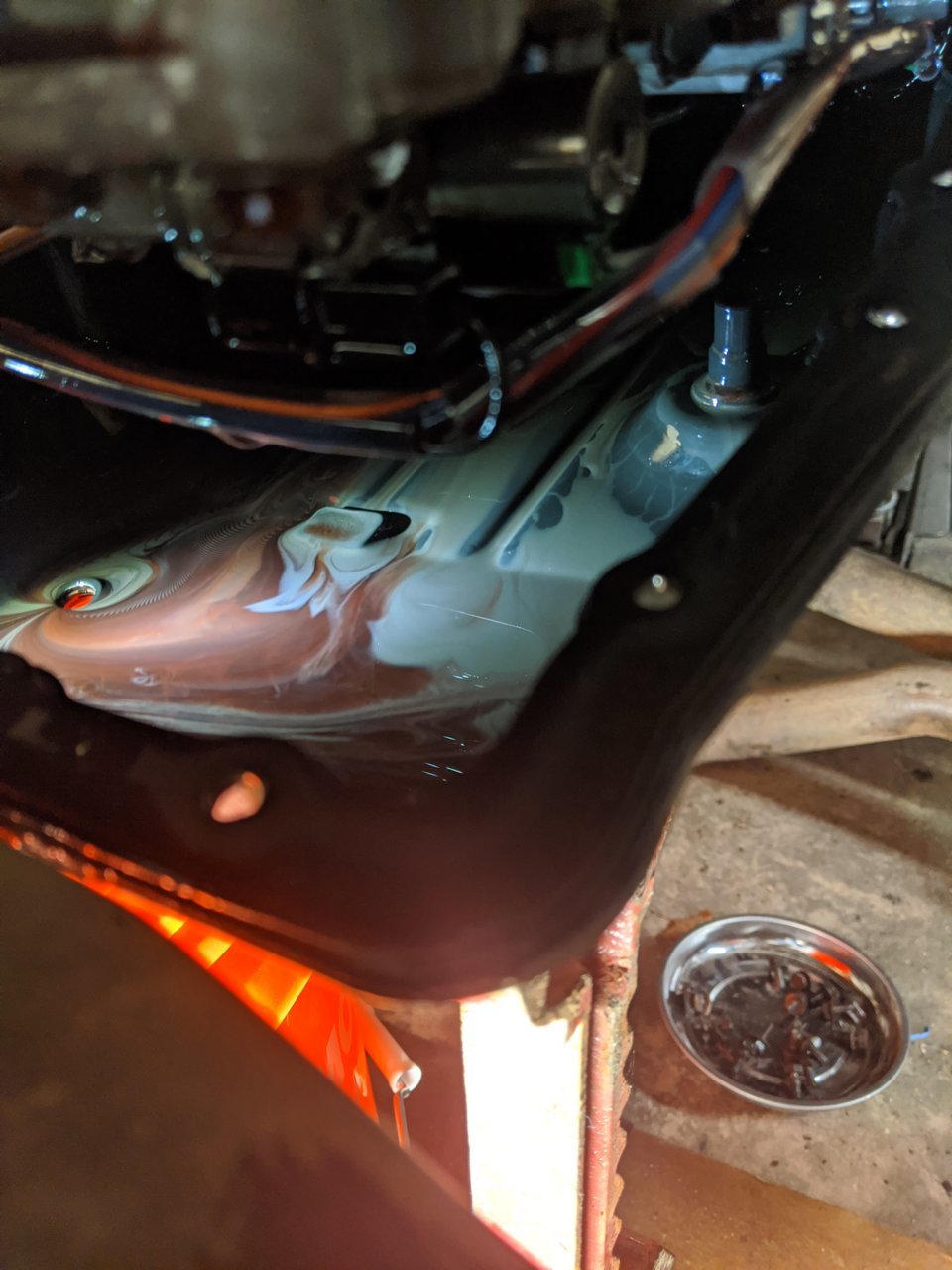

    @gearcruncher got a suggestion of what I'm seeing here? Truck has sat in the garage for the last 2 months. Moisture build up internally, or radiator mixing fluids? Or just the result accelerated wear and now's a good time to replace? Fluid wasn't exactly milky, more like graphite so I'm leaning more towards internal wear vs water contamination. I only observed the discoloration once 99% of the atf had been drained. It appeared red in color while it was draining.
    2006 A750F with 195k on it.

    Signs of moisture for sure . .
    Does your antifreeze have oil globules floating in it ?
    Have you taken the truck for a swim ?

    Not sure. I'll have to check the radiator. No swimming, just parked. I'm thinking now's a good time to swap in that spare trans I have.

    We see this on Hilux's, the stock transmission cooler in the bottom of the radiator cracks and coolant mixes in with transmission fluid.

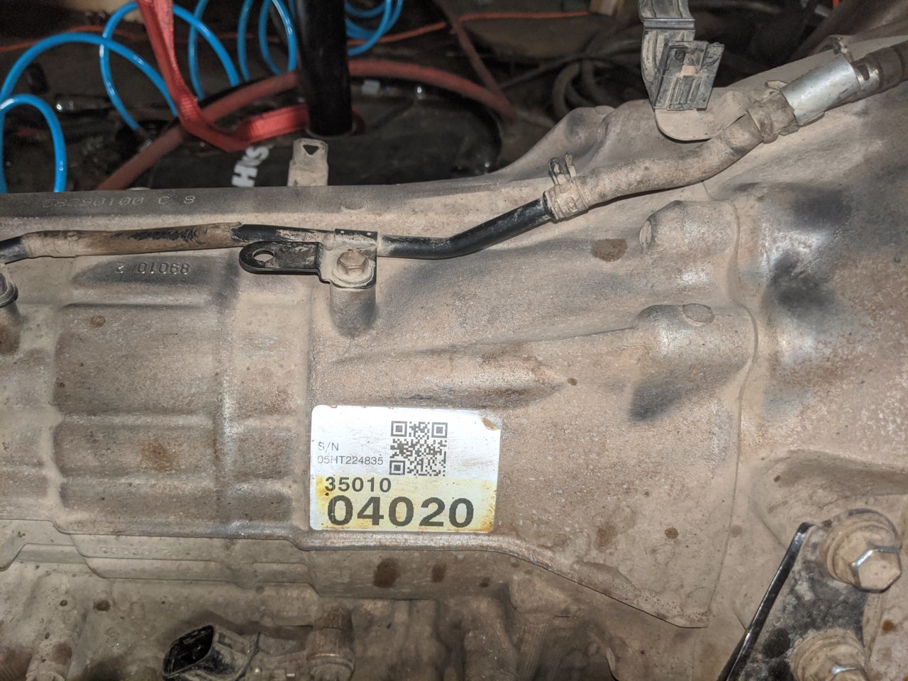

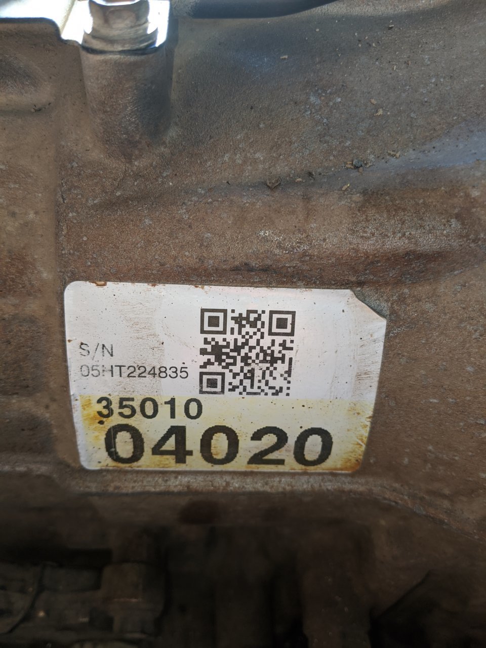

    Thanks again, you've been a big help with all of my transmission related problems.
    I'll soon find out if that 2012 t4r a750f will work in my 2006
    Replacement trans from 2012 t4r
    Old trans from 2006 Tacoma.

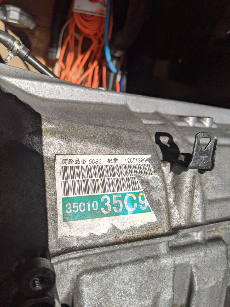

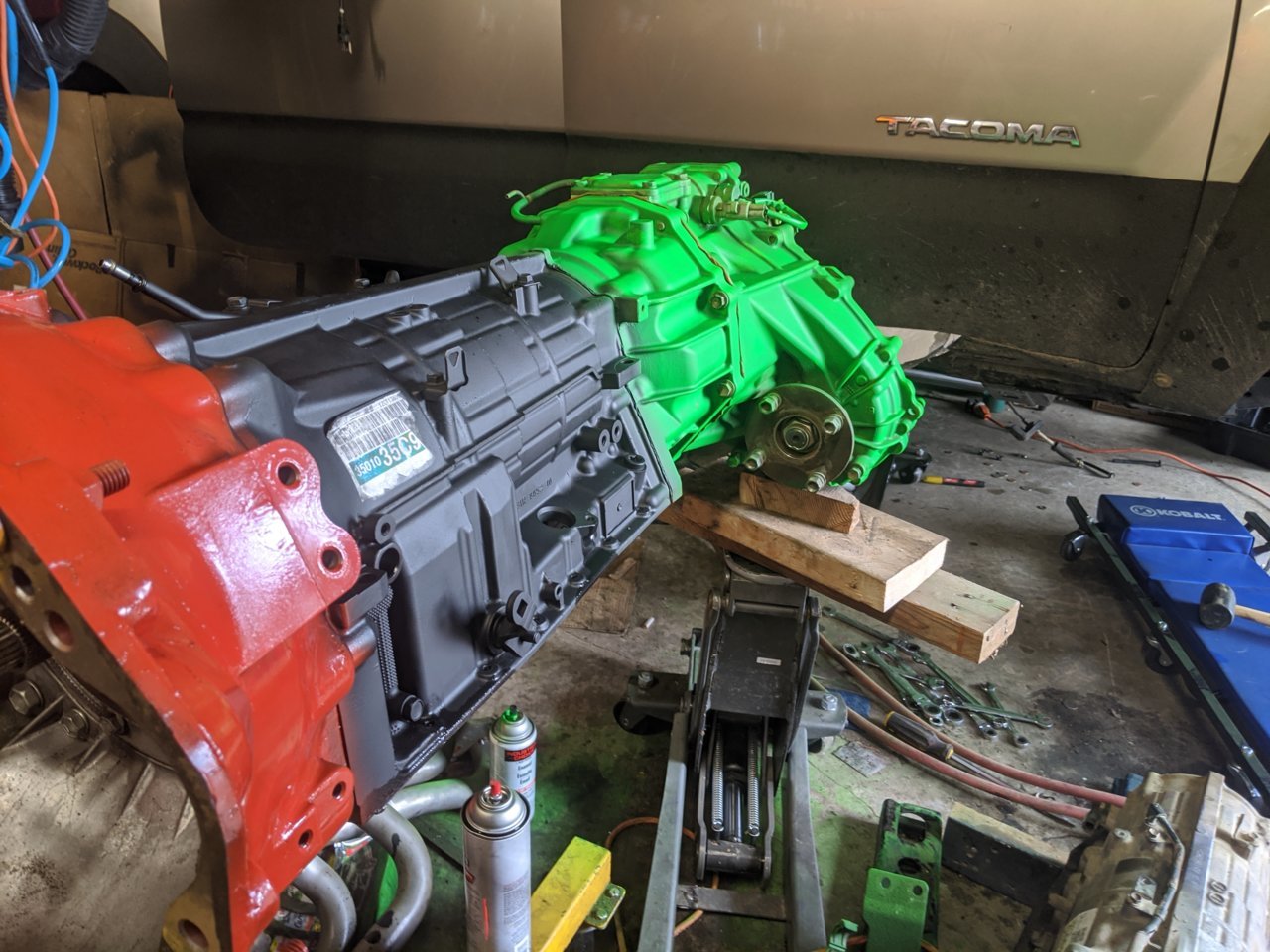

    So far I've got about 200 miles on my transmission swap using a 2012 t4r a750f with manual shift tcase behind it and no problems from install to driveability. I even used the t4r BH stamped bell housing which I was hoping wouldn't bite me in the ass and be just slightly different than the Tacoma bell housing. So unless I'm gloating too soon, it would seem any a750e/f from any vehicle Toyota offered it in, will interchange where another a750 was. You're not locked into the year range that Toyota says will only interchange with your year truck.
    My 06 a750
    The 2012 t4r a750. Note the Japanese writing, I'm assuming this a750 is manufactured by Asin Warner in Japan? Since the t4r is manufactured in Japan.

    Update: Just finished a 400mile road trip consisting of mostly highway travel, over 2 mountain passes and speeds of 70-85mph and not one issue. Trans shifts like a dream with TC temps peaking at ~205°F on the longest grade and averaging 180°F the rest of the time. Truck was moderately loaded with camping gear, and just me solo in the truck no trailer. Next time I wouldn't hesitate to source a A750F from a 2015 Tacoma with low miles for a swap.
