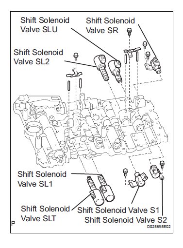

    Can anyone identify which solenoid is the SL2 (pressure control solenoid "B")? I need to replace this solenoid for a P0776 code but not sure which one it is?

    I think I determined that (based off that picture) the panel is "facing to the left" as in the cirlce in the middle left side is where the filter connects, which would place the SL2 as the bottom left most solenoid.
    I did PM him with additional info and waiting to hear back! hopefully he responds.
    I also NOW need to know the SLT solenoid, since I think i want to replace both, since they each talk to one another in relaying the data to the ECM and I only want to pay labor once, not twice to crack the pan open to swap out. This is def a task someone could do in a garage but with moving in less than 2 weeks and a 3 month old baby, I dont have the time to tinker with this project as I'm boxing up a house and coordinating with moving companies!!!

    FOUND IT! i think

    I swapped the SL2 and SLT solenoids with new OEM ones, changed the filter and drained about 5.5 qts and put new in. runs and shifts like a champ! so one of those things fixed it haha

    my ultra gauge showed the pending P0776 code, which told me it was either the SLT or SL2 (both are utilized in the switching from 3rd to 4th gear, which is where mine was hanging up). I did have the toyota dealer verify on their machine the same code. Toyota told me they wont open the xmsn, only swap out a new one ($3000+) which I called bullshit on. I bought the two solenoids, OEM (203 + 223$$) and had a reputable xmsn shop replace it. it seems easy, but I was about to move from GA to WA and didnt have the time and my tools were packed already. It can be done in 2-3 hrs, really just dropping the pan and filter, swapping solenoids, and putting it all back together and filling the xmsn again).
