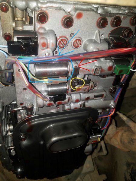

  4. Mar 12, 2017 at 9:04 AM
    #84
    mightytacoman
    mightytacoman Mighty-known Member
    Apr 3, 2013
    #101270
    2,411
    Kel
    4.5L 1grfe
    Brian Crower stroker kit, Carrillo pistons moly/ceramic coated, BC sportsman rods, arp s2000 head bolts, Darton M.I.D sleeves, Kelford race cams, Magnusson supercharger, hp tuner tuned, 650cc flow matched fuel injectors, CSF radiator, Walbro 255 fuel pump. pulleyboys quick change pulley with 2.3", fpr mod, NST crank, water and alternator pullies, 160° mishimoto thermostat. Puma On-board air, Radflo CDC ext coilovers with 14" 700# springs, extended length rear Radflo shocks with CDC, Dakar leak pack, Brute Force Fab front bumper galvanized and powder coated, DTRL mod, yellow fogs, fog anytime mod, relocated rear differential breather, synthetic fluids, custom airbox, tundra sized intake. 76mm throttle body, secondary air filter removed, Airflow snorkel, 4x innovation sliders powder coated, URD equal length headers, DT y-pipe, Aero-Turbine 2525xl exhaust dumped over axle, seat belt chime disabled, Warn 8000i winch, 1- 20" slim light bar in grill, 42" curved roof light both with custom brackets. Mesh grill, Brute Force Fab rear bumper with extra reverse lights, u bolt flip kit, SS extended brake lines, hockey puck bump stop extension, AT shackle flip kit, Light Racing UCA's, 4crawler 1.5" bodylift. custom built front and mid skid plates, re-geared to 4.56s, windows tinted 25%, Sony stereo, 8" skar sub-woofer, 1000 watt mono amp, retrofit headlights with legal demon eye, Kryptek Marathon seat covers. North Star agm 27f battery, Helo 791 rims, 315/75/r16 Mt/r ARB front air locker
    Slu solenoid is circled in blue. Need to loosen bolt circled in yellow to remove retaining pin at the red arrow. Then you can remove the slu solenoid enough to access the Allen key inside to turn it in. I also filled with valvoline synthetic atf, added 15oz lubegard and dr. tranny instant shudder fix. Truck honestly shifts better now than it ever has. @gearcruncher. Feel free to steal photo and add to original post or as needed. 20170312_114546.jpg
  5. Mar 17, 2017 at 7:17 AM
    #85
    Pickeledpigsfeet
    Pickeledpigsfeet Well-Known Member
    Sep 19, 2013
    #112813
    1,229
    Foothills, CA
    How far did you turn it? And clockwise or counter?
  6. Mar 17, 2017 at 8:23 AM
    #86
    mightytacoman
    Apr 3, 2013
    #101270
    2,411
    Kel
    4.5L 1grfe
    I did one full turn in (clockwise) this was about a week ago. Still happy with the results. I might end up backing it out a quarter turn as the tc really engages well now maybe too well. I also recommend resetting shift points etc by disconnecting the battery for half hour or so
  7. Mar 17, 2017 at 10:05 PM
    #87
    07 sport 4x4
    07 sport 4x4 Well-Known Member
    Dec 24, 2010
    #48165
    1,453
    Blake
    Southeast
    2017 Duramax
    What does this do? Up the line pressure?
  8. Mar 17, 2017 at 10:07 PM
    #88
    mightytacoman
    Apr 3, 2013
    #101270
    2,411
    Kel
    4.5L 1grfe
    Slu solenoid is lock up control
  9. Mar 17, 2017 at 10:08 PM
    #89
    07 sport 4x4
    Dec 24, 2010
    #48165
    1,453
    Blake
    Southeast
    2017 Duramax
    I'm asking about the screw you turned
  10. Mar 17, 2017 at 10:14 PM
    #90
    mightytacoman
    Apr 3, 2013
    #101270
    2,411
    Kel
    4.5L 1grfe
    I turned the screw in the slu solenoid. Basically it changes how how tc engages and what it takes to fully engage/disengage. Over turning it will make it so it locks up too much for instance
  11. Mar 17, 2017 at 10:17 PM
    #91
    07 sport 4x4
    Dec 24, 2010
    #48165
    1,453
    Blake
    Southeast
    2017 Duramax
    Are we talking about lockup timing or force? These transmissions have a ridiculously soft lockup.
  12. Mar 17, 2017 at 10:21 PM
    #92
    mightytacoman
    Apr 3, 2013
    #101270
    2,411
    Kel
    4.5L 1grfe
    I have to refer to @gearcruncher for this info, he knows more than I do about the technical aspect of what the screw does.
    07 sport 4x4[QUOTED] likes this.
  13. Mar 18, 2017 at 4:55 AM
    #93
    gearcruncher
    gearcruncher [OP] Well-Known Member
    Nov 1, 2012
    #90305
    7,176
    Canadain bumper technician
    Great white North 51.0333° N, 93.8333° W
    2010.TRD.SportDCLB4x4Limited leather package
    TRD Sport Rally -5 speed automatic Limited ,Factory heated leather seats ,chrome package,Super white with front windows tinted to 35 % Dick Cepek DC-2 wheels Summer tires - Good year silent armor P265/65R17 Winter tires - Good year P265/65R17 Ultra Ice studded Illuminated 4x4 switch TRD 3rd brake light cover ($20) TRD seat belt shoulder protectors (5). ($50) TRD ...B pillar emblems ($20) TRD rear slider sticker with devil horns ( $6) TRD summer floor matts ($60) TRD steering wheel emblem ($20) TRD floor pedals .($95) TRD shorty antenna ($14) TRD front Windshield emblems ($17) TRD head pillows .($60) TRD head rest protectors TRD door scuff protection $20 TRD floor matt emblems ($40) TRD tow plug emblem . ($40) TRD cigarette lighter with LED.($35) TRD tissue dispenser ($12) TRD front bezel emblems ($9) TRD door emblems ($6) TRD lanyards($9) TRD lisence plates with TRD bolts($50) TRD fender emblems TRD center caps Part Number:PT904-35070-CC ($80) TRD cd
    1/4 turn , anything more than that and the shift into lock up becomes very aggressive . Not so bad with transmissions that only lock up in 4th gear but if you get a partial lock up in 2nd and 3rd , its going to cause some drive ability issues from the butt dyno.
    Turning the screw clockwise 1/4 turn increases converter application pressure by 30 % . With this said , the only time you should increase converter lock up pressure is when you are trying to fix a converter shudder . Keep in mind that these trucks are designed to please everybody when you purchase the truck from the dealer . Good for grandpa on a Sunday drive or the soccer mom . They shift smooth and smooth equals slip/ heat .
    With this said , and if you are planning to keep the truck , you can tailor any upshift or downshift to what you desire .
    Best time to make a modification to shift quality is when you are due for a fluid and filter service
