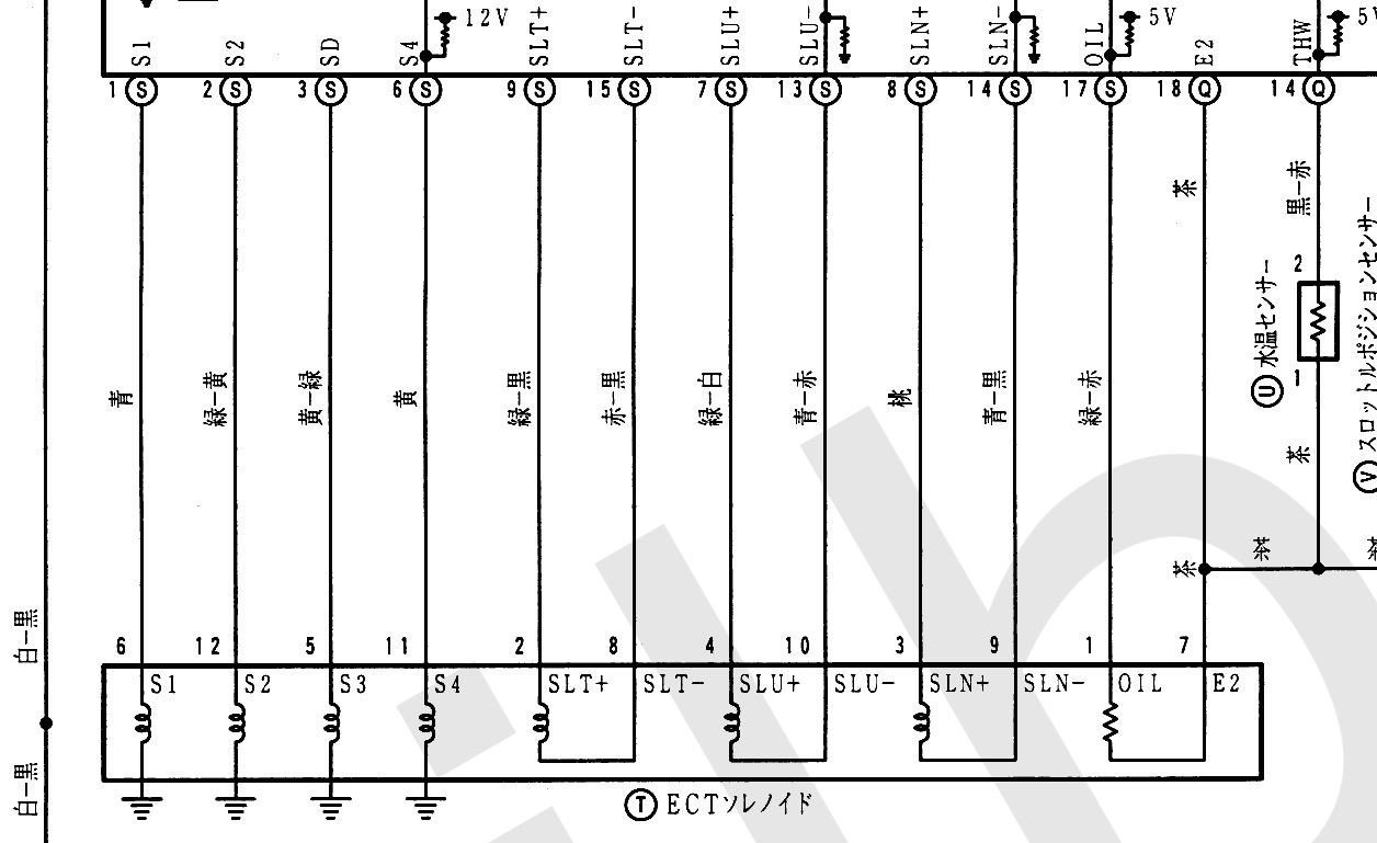

    Wow, amazing thread I stumbled on (though a lot of your links need updating). I have a ton of questions, but most prudently, @gearcruncher are the shift solenoids (S1 & S2) PWM or DC in the A340E?
    You link to the Supra forums suggests they are PWM, but I have not found mention of that in any service manuals or descriptions of operation. The counter-information has been that pressure controlled by the throttle linkage, but I am not read enough on transmissions yet to know if they are referencing the same thing.
    Thank you

    Hey Trey
    S1 and S2 are just on/off solenoids controlled by 12 volts direct current from the pcm . They are not pulse width modulated .
    Yes , a lot of links are dead . I will fix it up next winter
    Send me your e mail using a pm and I will send you the solenoid manual for verification

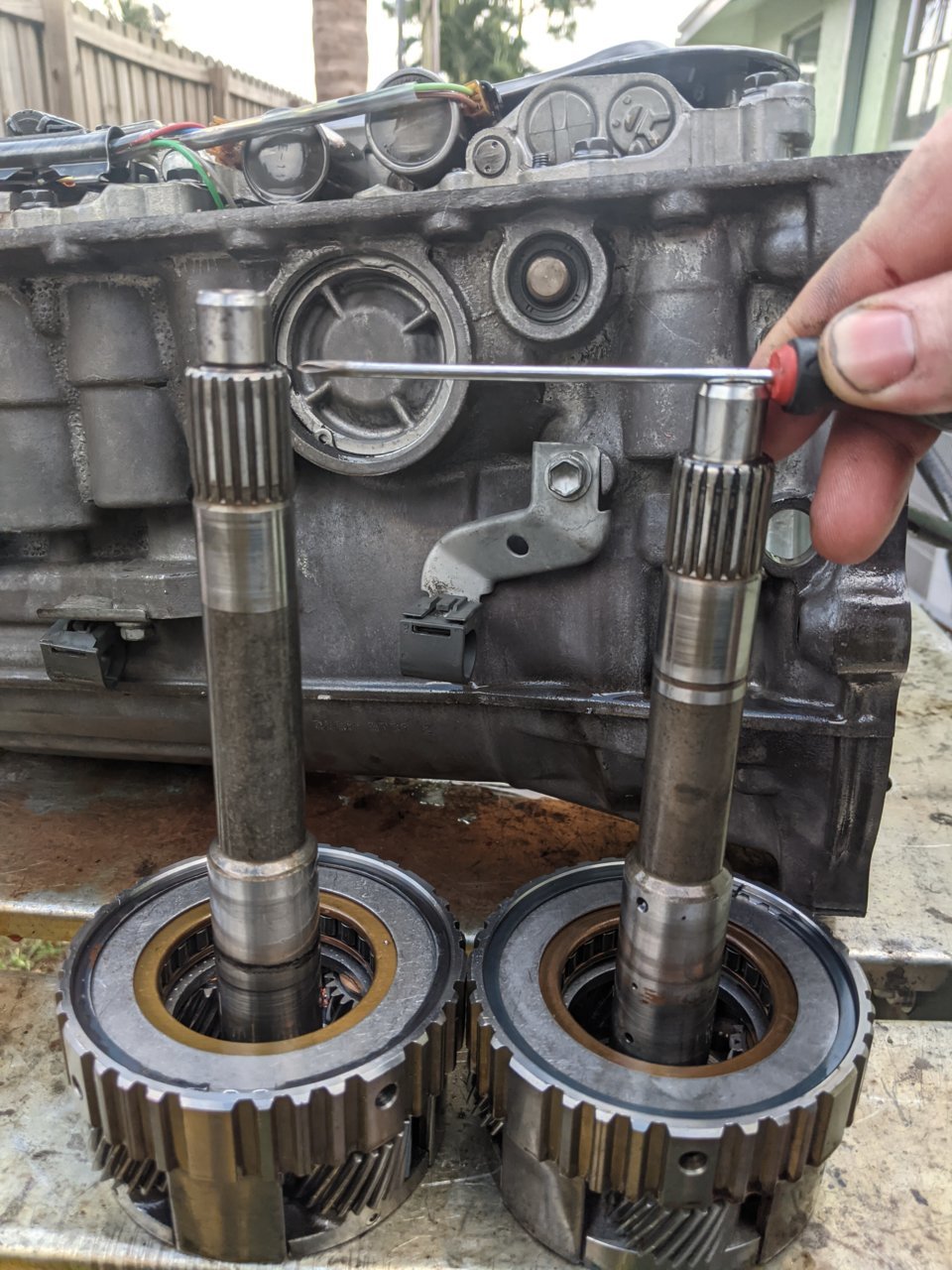

    So there is a difference between input shaft and pump lengths depending on the engine.
    The left is a 1uz v8 and the right is a 1jz vvti shaft (I rounded the short one lol)
    There is a small difference with part of the pump as well. It mainly has to do with the size of the torque converter (1jz vvti is smaller than 1uz). If you're swapping torque converter/ bell housings make note of the shaft lengths as they might be different.

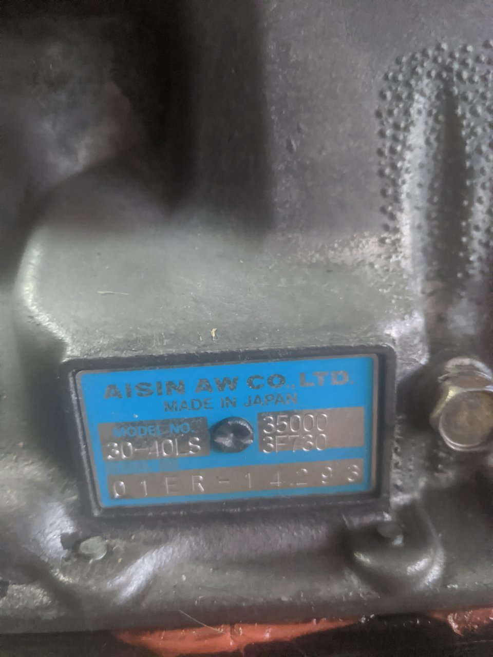

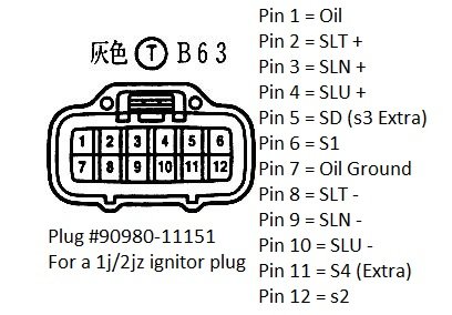

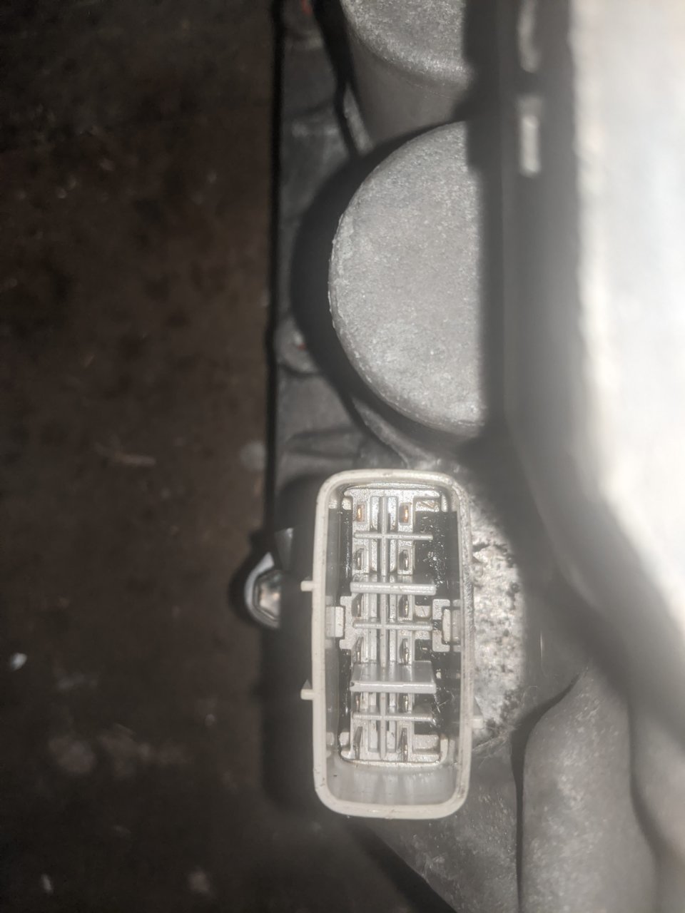

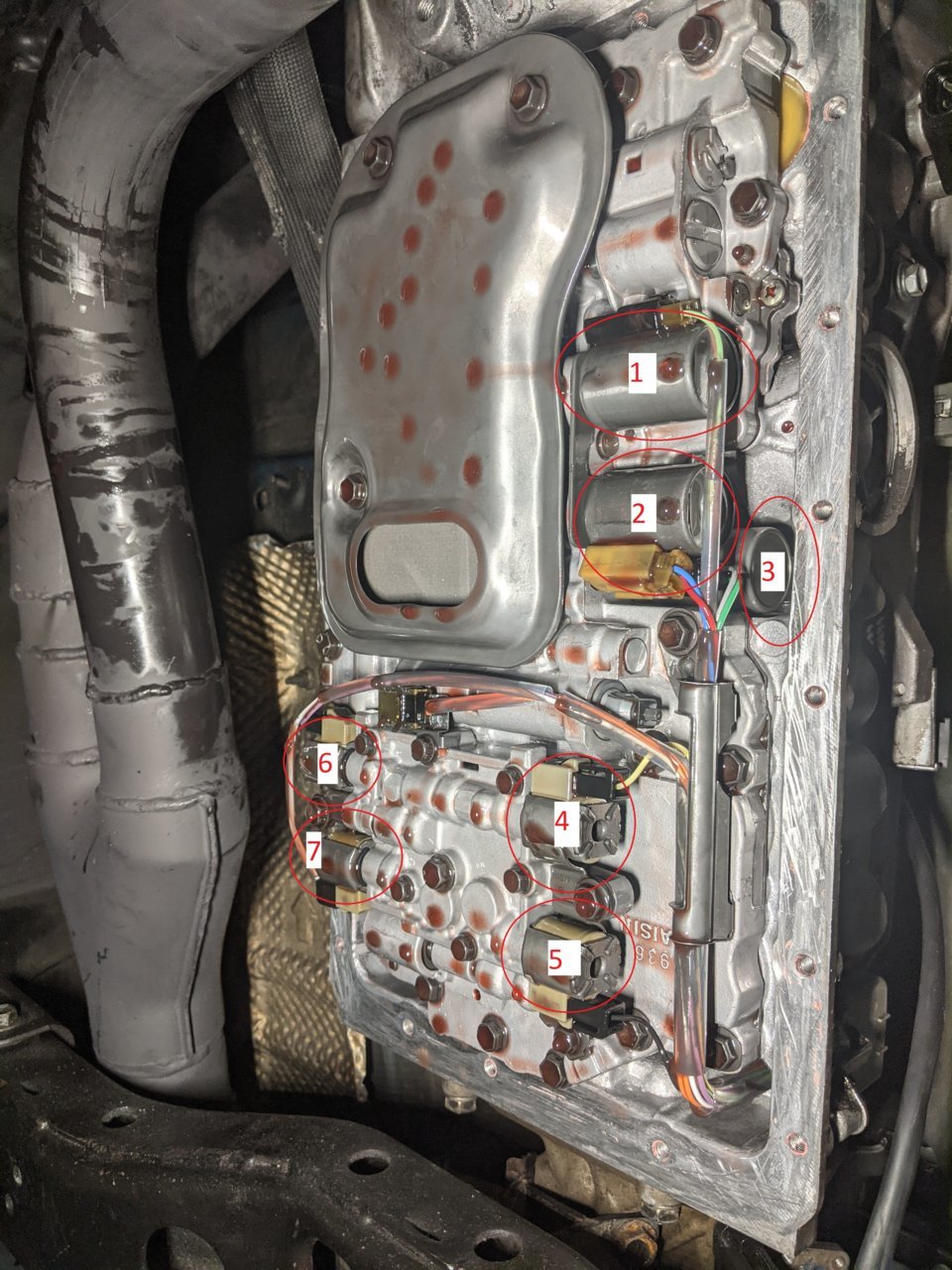

    If you're dumb like me and buy an a340e with the tiptronic, here is the pinout for the 12 pin solenoid plug
    Source that helped with pinout along tracing
    Picture of plug
    Valve Body (Numbers are just to show how many solenoids NOT THE ACTUAL ORDER)
    Serial Plate

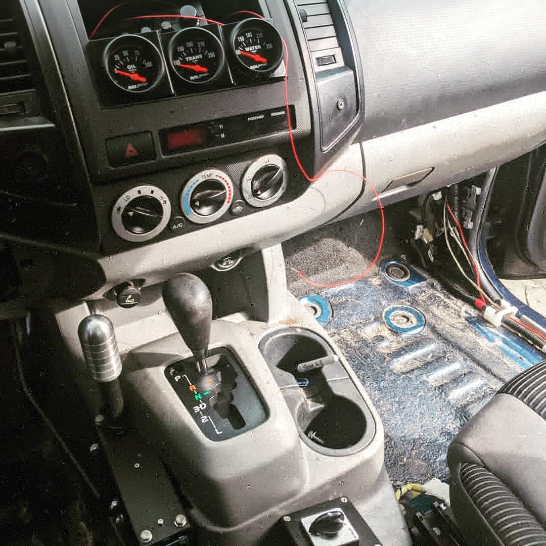

    There are plans to use an Arduino and a sequential shifter designed for racing simulators. The only issue is for now I don't plan to use the extra solenoids since you can get all the gears with out them. This trans is supposedly rated for around 500 hp so at least I got room to grow. The one thing for anyone reading this is you need a good sized cooler if you plan to run manualized in any a340.
    Here is the sequential shifter next to my oem shifter, Just waiting to finish up some wiring/programming.
