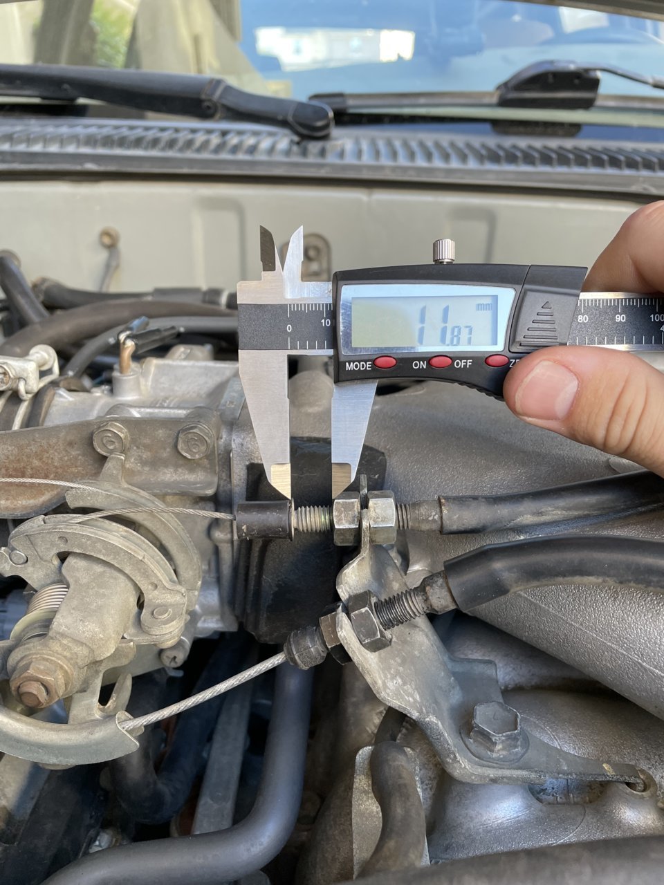

    Glad to see that this thread is still active. I’m having a small but annoying transmission problem with my 2000 4Runner V6 4WD with I believe the A340F transmission with the line pressure cable. Correct me if I’m wrong on the transmission name but I’m positive it has the line pressure cable because I have been adjusting it for the past year trying to get this problem to go away. Anyways, the transmission has never given me any codes or not shifted into gear, however it shifts really hard most of the time at medium throttle. It’s pretty smooth and acts normal at less than 20% throttle or greater than 80% throttle. But in the middle it shifts pretty hard. They all seem pretty positive but it’s not a quick jolt it’s more of a little shudder. It’s never slipped or not shifted and has plenty of power for what it is.
    Here is what I’ve done in order to try and fix this issue:
    - Drain and filled multiple times with Valvoline Maxlife ATF
    - Replace transmission filter and added external cooler with inline magnifine filter
    - Replaced both throttle and line pressure cable
    - Greased rear end of driveshaft because it was clunking at stop lights when releasing brake petal(fixed that problem but not shift problem)
    This is probably not related at all, but since doing those things, I also replaced my muffler with a louder one and can hear the shifts now, they sound very clean, crisp, and smooth but still has a bit of jolt when shifting. Only way I can seem to get it to go away is WAY loosen the line pressure cable but then it doesn’t like to downshift.
    Also, when pressing the gas petal while car is at speed, (enough for the car to have to downshift) there is an initial clunk then it downshifts, which is EXTREMELY annoying cause it feels like something is breaking.
    Trans temps usually stay between 150-175F.
    @gearcruncher ive read probably every forum on the internet about people complaining about transmission problems and none of them seem to be similar to my problem which is why I still have hope for my transmission. What do you think?
    Any input helps, thank you!

    The adjustment procedure for the cable is on the first page at the bottom of the first post in pdf format .
    it sounds like your cable is way too tight.
    Those cables do stretch over the years and need periodic adjustment .
    If you dont make adjustments to the cable from time to time , the transmission begins shifting very lazy to the point where its almost slipping.
    A good time to look at the cable adjustment is when you do your routine transmission servicing
    That cable tells the transmission where your foot is on the gas pedal
    When the cable is too tight , the transmission thinks you have your foot mashed to the floor so the transmission ramps up the pressure to compensate ....upshifts will be late and agressive
    When the cable is too loose , the transmission thinks you are hardly into the gas pedal , so upshifting will be very early and super smooth to the point where you may not feel the transmission upshift and downshift ...Not good .
    Most guys prefer a crsiper shifting transmission . I certainly do
    The less time it takes for the transmission to shift reduces friction and heat build up inside the transmission .
    Try telling that to a soccer mom or grand parents out for a Sunday drive .
    Thats why Toyota engineers design a little slip in the automatic trans . Gotta make everyone happy .
    Then there are the guys seeking the 1200 horsepower upshifts that throw you back in the seat when the trans shifts . Thats not good either . The planetary gears inside the transmission can only handle so much load .

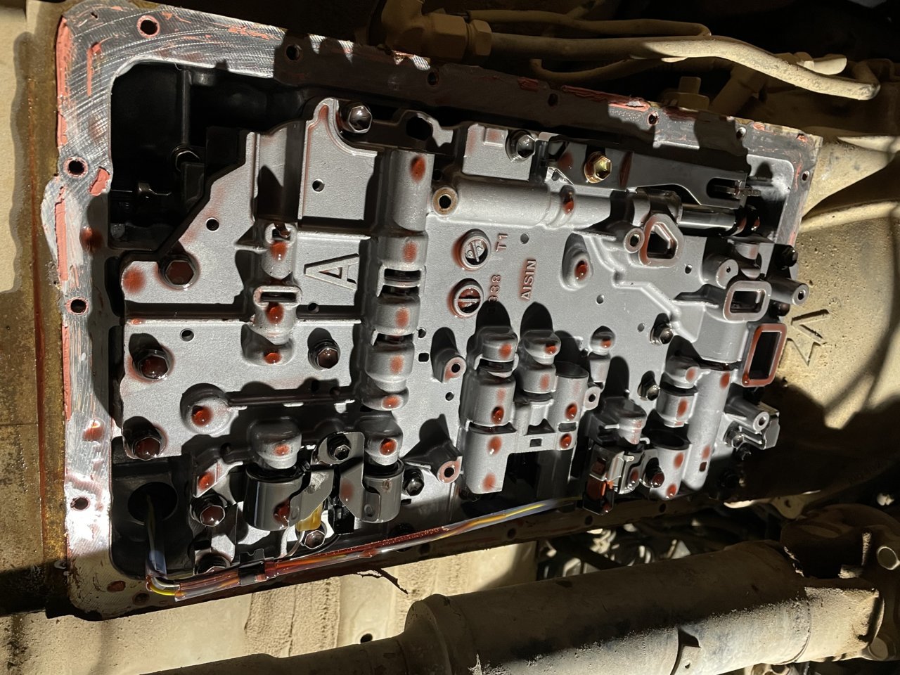

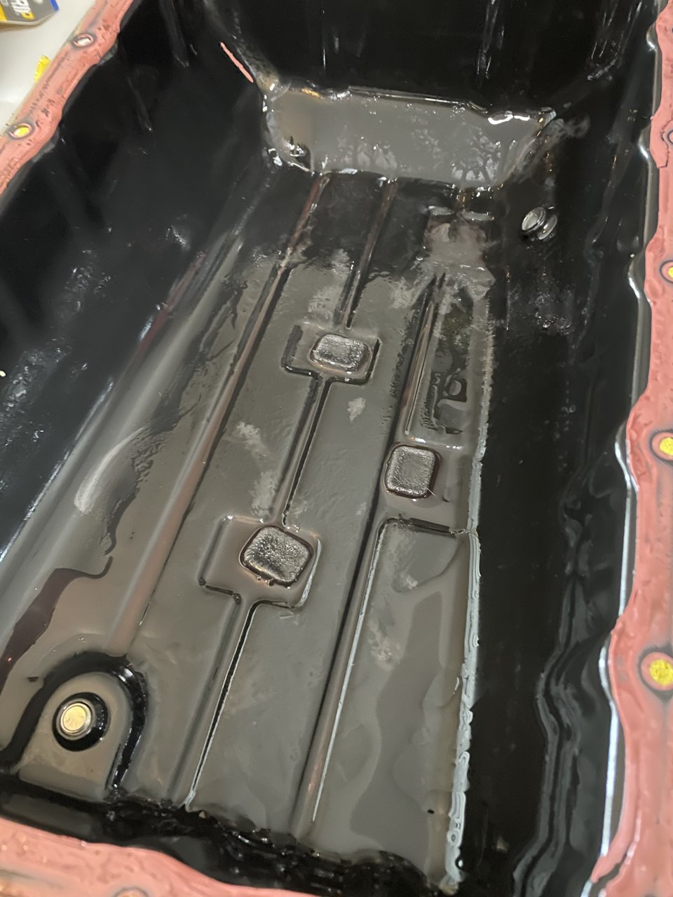

    What did the bottom of the pan look like when you replaced the filter ? was the pan full of junk ?
    Whats the mileage on the transmission ?
    If i had to guess , you have worn valve body components in the line pressure loop . This is usually caused by lack of fluid changes .
    Your issue is a common complaint with the A340 series transmission . I see it often
    I suggest following the cable adjustment procedure , then we can dig a little deeper if the adjustment doesnt solve it

    Thanks for the super fast response! I’ve read all about the adjustments for the cable, the little nob should be 1mm to 0mm out from the sheath. I did that and it made the shifts insanely hard. I will attach a picture of how loose it had to be for the shifts to be smooth. I will also attach a picture of the bottom of the pan, it had the original Toyota gasket maker on it so I’m assuming it has never been removed before my ownership. I replaced the line pressure cable cause I heard from someone else on the forum that it could be worn.(old cable in picture) The new one, OEM, does not have the little metal nob on it. Is there another way to get it close to adjustment without using the nob? The car has 205k miles. All original parts.

    Also, the fluid that I drained out originally around 195k miles was dark. It wasn’t burned and when put on a white paper towel you could still see a dark dark red color.

    There is another way to adjust the cable according to pressure but requires a zero - to 300 psi pressure gauge . There are pressure taps on the side of the transmission . I dont think the cable is the issue . The valving inside the valve body that your cable controls is the issue . They call this erratic line pressure control
    Those valves stroke 10,0000 times a day
    when the fluid is dirty , the fluid works like sand paper on your all aluminum valve body causing the spool valves to seriously wear out
    I think its time for you to visit the Sonnax website , punch in your information and see what they offer to restore the hydraulic integrity of your transmission .
