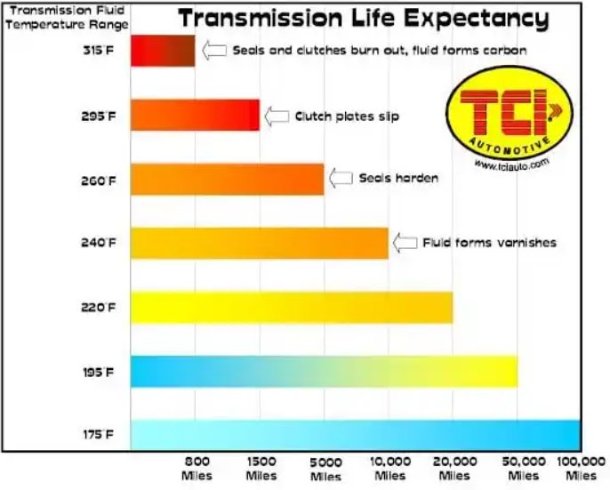

    Fluid replacement replacement interval is generally use/temp dependent.
    A good rule of thumb but I wouldn't take it too seriously since it from a website that sells coolers and fluid so I'm sure its biased a bit. I think 220 and below should be good for 65k miles. 240F is where you should be concerned. 300+ is "replace ASAP" (or pull over and let cool down :D):
    This is why you should know / monitor your trans temp, especially when towing / hauling.
