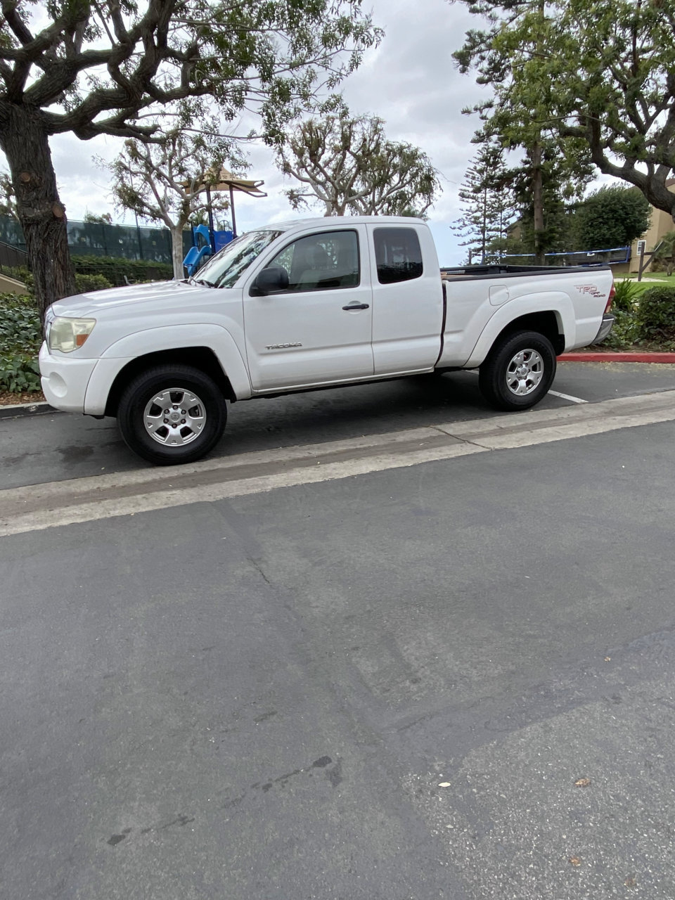

    Hello I am a first year college student and I bought a 2005 Tacoma Prerunner 4.0 In February 2022. When I got it home I saw that there was oil in the coolant so I flushed the coolant system and I never got any gasket symptoms. It had 106,000 miles apparently and I've put on 8,000 since with no major problems. It had this problem that when I'd accelerate and around 30mph it would Start vibrating like if you were driving on the side of the freeway with those loud bumps. It would go away if I stepped on the gas more. I fixed it by flushing out the transmission fluid and changing all of the sparkplugs. I finally tried to do a gasket test with that blue liquid but when I do it on the radiator, it sucks fluid. Is there a better way to test a gasket or a better way to confirm the state of your engine ? I also wanted to ask some stuff to see if any of you guys have this in your trucks. When its in park and I shift it into drive or reverse, it jerks forward or backwards depending if its on drive or reverse. Also when Im at a stop and start driving down hill it only makes it to 4th gear and doesn't shift to 5th so the RPMs go up. It won't shift until the ground is flat. Last the whole bottom of my truck is covered in oil. Like the transmission pan and the frame. How should I go around diagnosing the oil leak. I'm not too car savvy and I was hoping you guys can help. Thank you happy holidays
