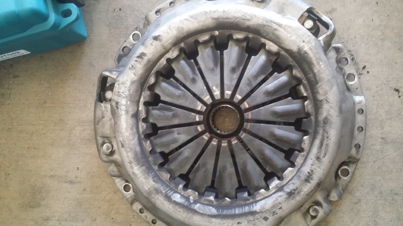

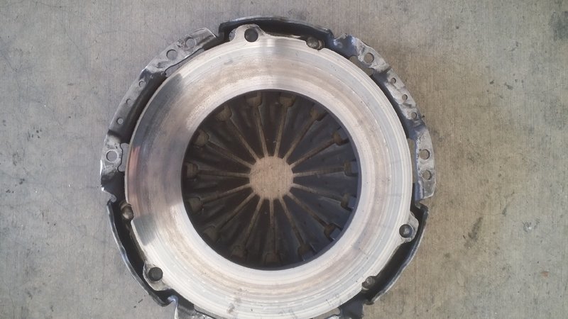

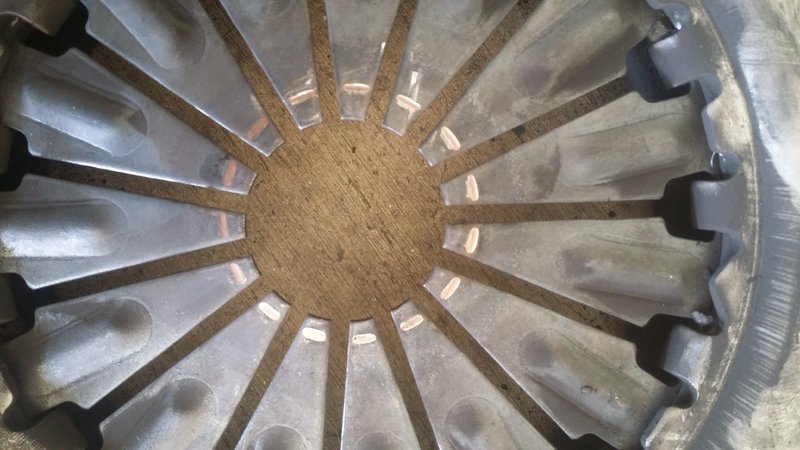

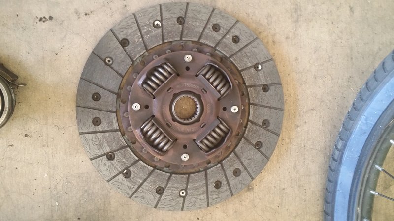

    Took the transmission out and pulled clutch and pressure plate after being installed for around 2000 miles. Couple things which I am concerned about;
    1, There was a LOT of dust inside the bell housing.
    2, Release bearing wear pattern on pressure plate.
    3, Some rivets on clutch show signs of polishing.
    4, Scratch marks on front of bell housing.
    Am I dealing with defective parts (pressure plate, clutch, release bearing) or is my transmission bad and causing this? Possibly transmission input shaft bearing?
  8. Aug 2, 2016 at 11:59 AM
    1988Mercedes
    1988Mercedes Well-Known Member
    Sep 18, 2015
    #164542
    265
    CHARLES
    ARKANSAS
    2020 AG PRO MT
    Clutch in backwards? There are two different sides.
  9. Aug 2, 2016 at 1:31 PM
    05RedTaco
    05RedTaco [OP] Nom Nom Nom
    Sep 20, 2010
    #43521
    1,751
    Tony
    Scottsdale
    2000 Tacoma XtraCab 2.7L 4x4
    Flat side was installed against the flywheel.

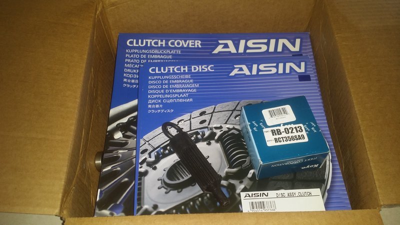

    Just placed an order for an OEM Aisin clutch kit. (clutch, pressure plate, release bearing and pilot bearing.)
    I am hoping that oem clutch kit will solve this problem...

    Good install with OEM clutch kit, can't go wrong there. Good choice.

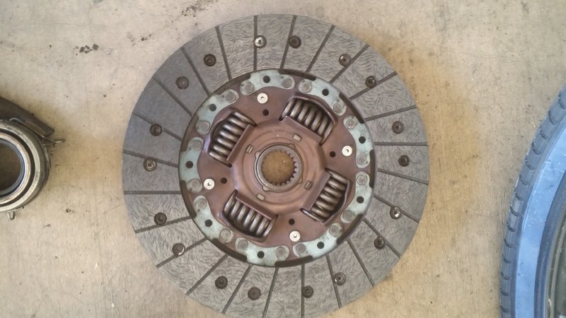

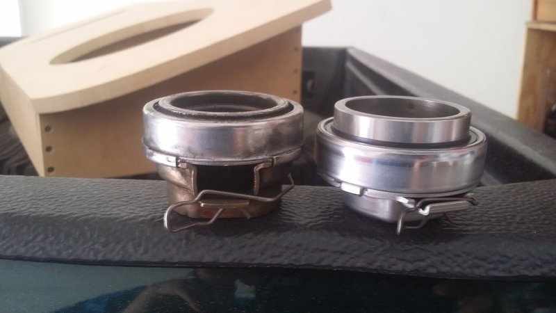

    Brand new OEM, clutch, pressure plate and release bearing.
    Old release bearing on left, Brand new Koyo release bearing on the right. They are quite different...

    Oooohhhh beautiful :cool:... Wish I was there helping put that thing of beauty in. I'm always blown away by the high quality, and it's easy to see when you have something to compare it to, of the OE Toyota uses in their trucks. For example the wheel bearings in my Cruiser look like they belong in a full-size 1 ton pick up. Bea-u-ti-ful. How about some pics of the Aisin clutch and pressure plate??? Please... Pretty please? o_O Yeah, yeah, I know I'm weird already

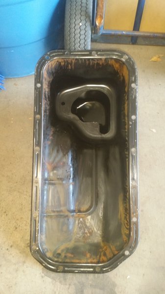

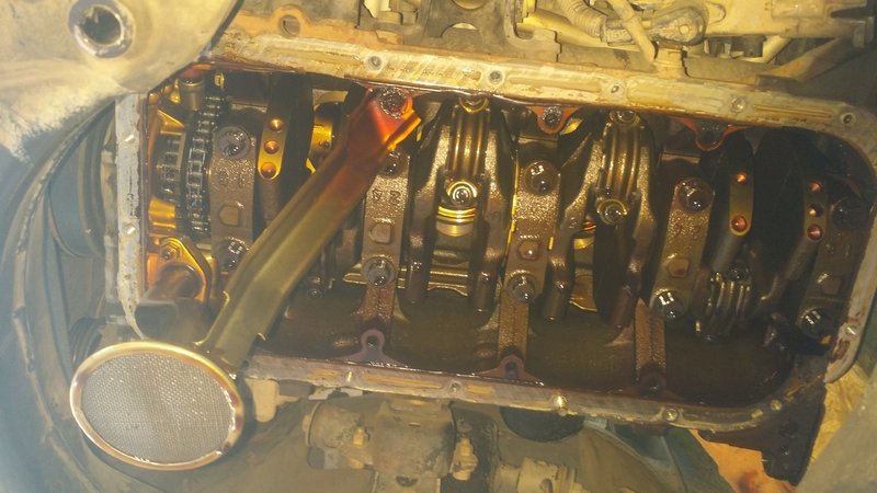

    3RZ bottom end at 280k miles. Looks great!
    Oil pan cleaned and ready to go back on.

    It does look really good. I'm very impressed with Toyota bottom ends. I've been into a corolla with that mileage and still saw cross hatching in all of the cylinders. Amazing. Keep the pics coming, if you don't mind for us nerds. Nice work

    Yup with Aisin kit it shifts great!
