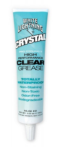

    This thread really helped me out so I thought it would only be fair to leave my input.
    My clutch had a horrible squeak and had a strong resistance when pushing the pedal.
    Finally I followed through with this threads "fix". I took the two bolts loose holding the slave cylinder in place creating a little more room to fit a bamboo skewer with grease on the end to the clutch fork ball pivot area. The metal pin / ball-end fell out of the slave cylinder while it was dangling there. I noticed the ball-end of the pin was another friction area so I greased it as well and slapped it back into place. Afterwards I pumped the clutch and it still made a light squeak noise. However, the next morning it was completely silent and smooth as butter when pressing the pedal. I cannot believe how much better the clutch performs and sounds now. It's like a new truck. I would recommend doing this to every clutch that is stiff and noisy. Below is the grease I used.
