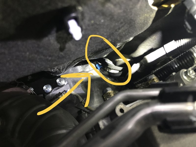

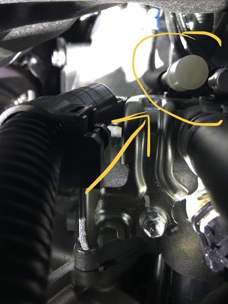

    I ran out to my 4Runner and took these pics. I'm pretty sure the two lines are the breathers
    fatfurious2 likes this.

    I'm sure I felt the trans and transfer lines tee together and then head up toward the engine bay. I assumed it terminated in my pic. I will have to trace them more closely.
    Until then I stand corrected.
