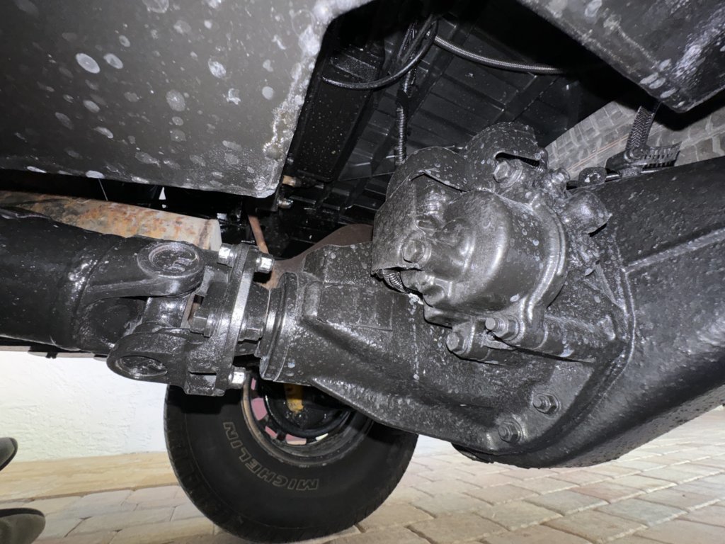

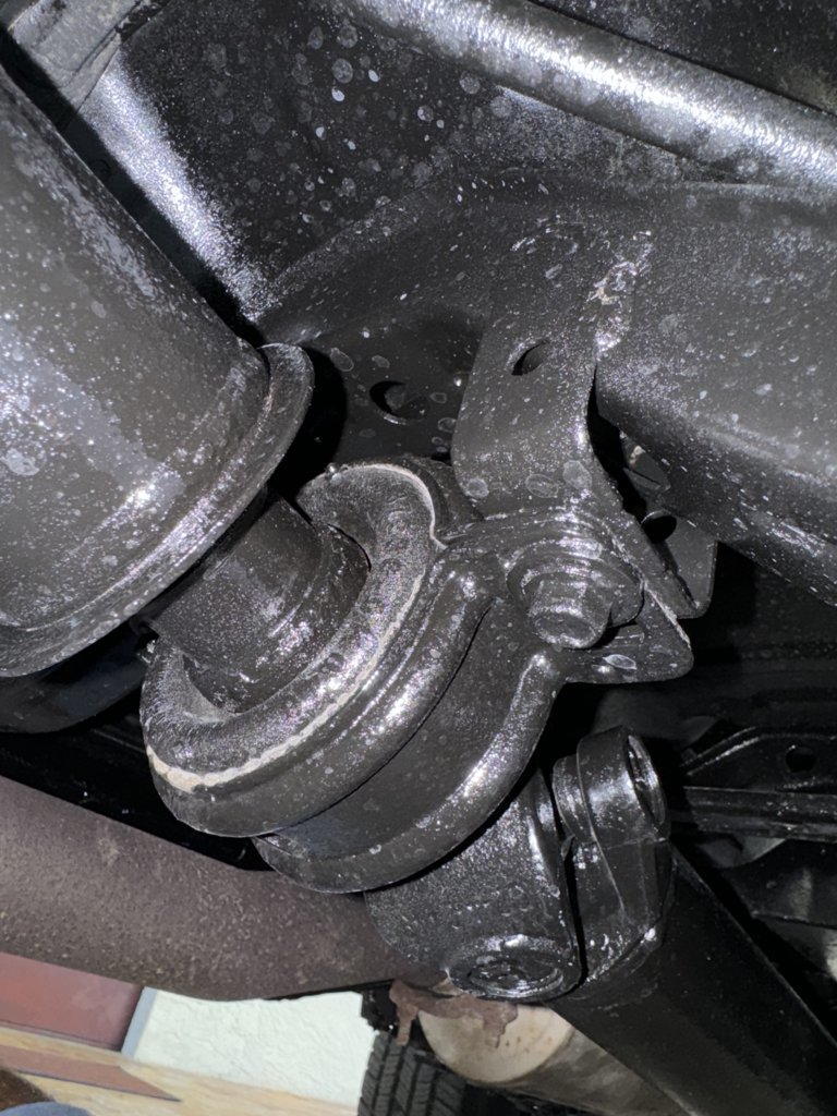

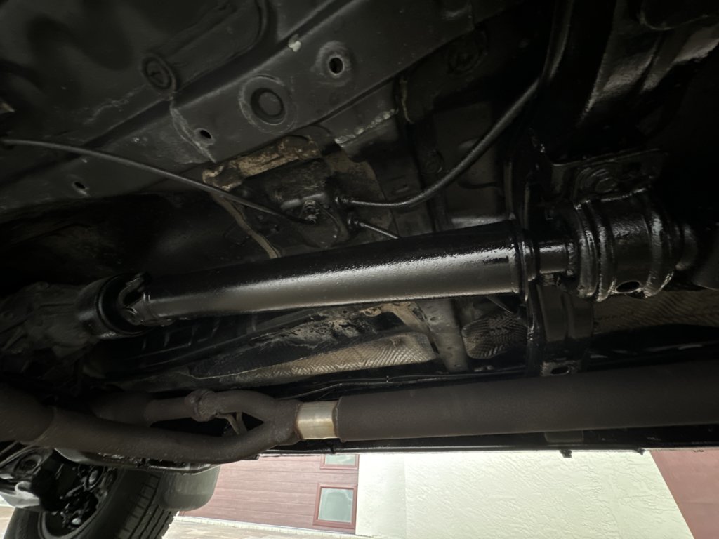

    Post a pic of the driveshaft.

    Will note that my drive shaft was recently Por15’d along with the frame.

    Center bearing looks ok, I guess. Shit, I don’t know.
