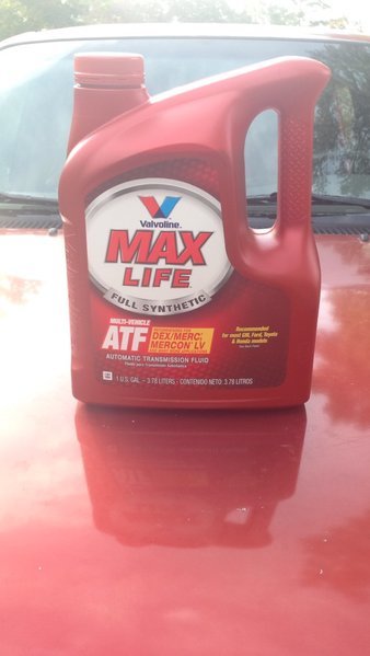

    Go buy some max life synthetic at wal-mart. You can buy enough to do a flush yourself (it holds about 3 gallons, I bought 4) for 60 bucks or so...
    If you look on the jug, it specifically mentions compatibility with Toyota WS. Many of us here have done this and had zero problems, perhaps better shifting for some.

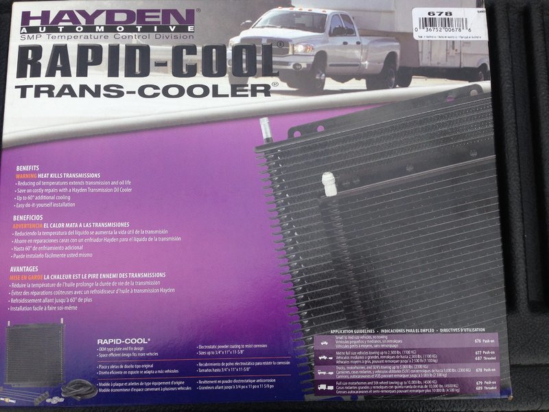

    I drained my transmission fluid, installed a transmission cooler and filled it with new Type IV fluid. I didn't change the filter, the dealer suggested that I leave it. Call your dealer service department and ask them about the strainer/filter. My transmission is running smooth and the fluid temp is 30-40 degrees cooler.

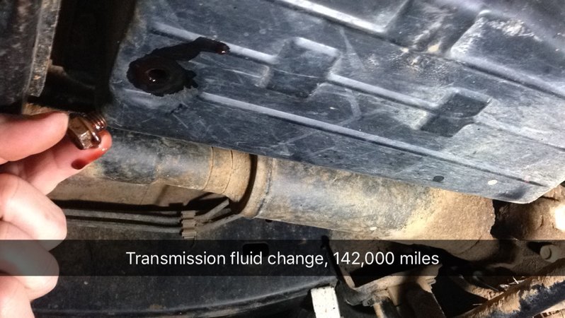

    I just did a drain & fill last month. dropped the pan and changed the filter & gasket. I let it drain for awhile while I did other things (eat & watch football really)
    I ended up draining a little over 6.5 quarts in total (with TC total is ~15q). I got Mobil 1 Type IV synthetic ($58 for a case back last year when I bought it) and the filter/gasket for $30 on Amazon.
    The fluid was getting brown when I changed it and is now (even after driving) a nice light red color. No pumps or machines needed.
    The hardest work was like others mentioned, getting the old gasket crap off. I think I'm a little over the full mark but it has not affected the shifting.
