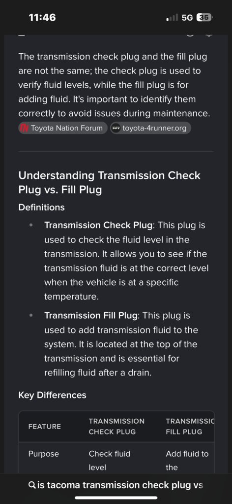

    Do i check the transmission fluid by putting level on the flatest serfice on the pan itself? I have 2+ lift front and I have to jack up front end about 12 inch to get pan leveled

    As level as possible and it's a long procedure

    Park on a level surface and jack up the rear 2".
