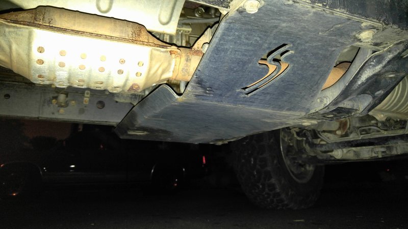

    UPDATE:
    Took my truck into a local auto shop today, guy told me that my trans skid plate got pushed up against the transfer case when it hit one of the rocks I was crawling over. So whenever I was shifting under high RPM, it would rub against the skid and make the grunting/grinding sound I was hearing.
    They took it off and bent it back into shape, issue is resolved!
    Good thing I had that skid plate or I may have lost my 4x4 out on the trail...

    That little stock t-case skid is ridiculous. And now that it's been collapsed once, it'll do it even easier the next time.
    It may be time for a set of real skids.

    I have an aftermarket skid plate under there

    Pretty sure if I had a stock plate there it would've been much worse lol

    I've always wondered how well the skidrow belly skid holds up, now we know. :rofl: Tho I suppose, if you come down hard enough on any skid its gonna give.

    That's what brand it is! Haha I've been trying to figure it out ever since I got the truck. Thanks! Lol

    Yeah honestly I bottomed out on that rock REALLY hard, I think that skid held up pretty well considering. It just sits pretty close to the t-case is my only concern, there's maybe an inch worth of space between
