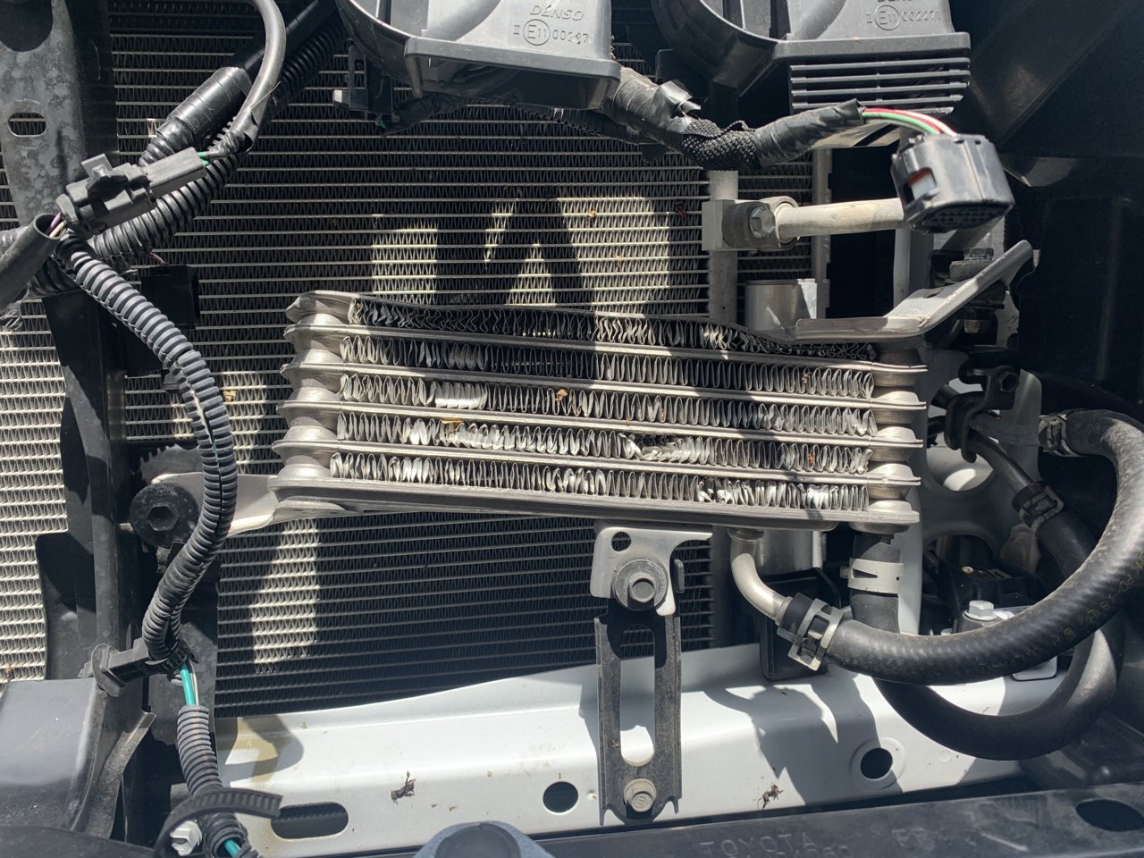

    So I just bought a used 2020 Tacoma 4x4 Off Road with 8000 miles on it. Seemed like a good deal but I didn’t do a thorough enough inspection when I got it from the auto broker (should have bought new).
    Turns out the fan shroud is cracked, the airbox is also cracked, and the trans cooler has been crushed and pushed up a bit.
    I’m determined to fix these myself but a few questions. Should I get a better transmission cooler to replace the standard cooler? And should I go ahead and upgrade my air intake to a cold air intake? I have read mixed reviews on the cold air intake and most modifications I have seen with the trans cooler is putting an additional cooler on, rather than replacing the standard cooler.

    How would all that seemingly unrelated and random stuff be broken at only 8000 miles? Is this a salvage rebuild?

    If this thing is legit, all of this is covered under warranty at no cost. But with broken things like that, it raises a big red flag of a decent wreck, possibly a total and rebuild - a poor one it seems.

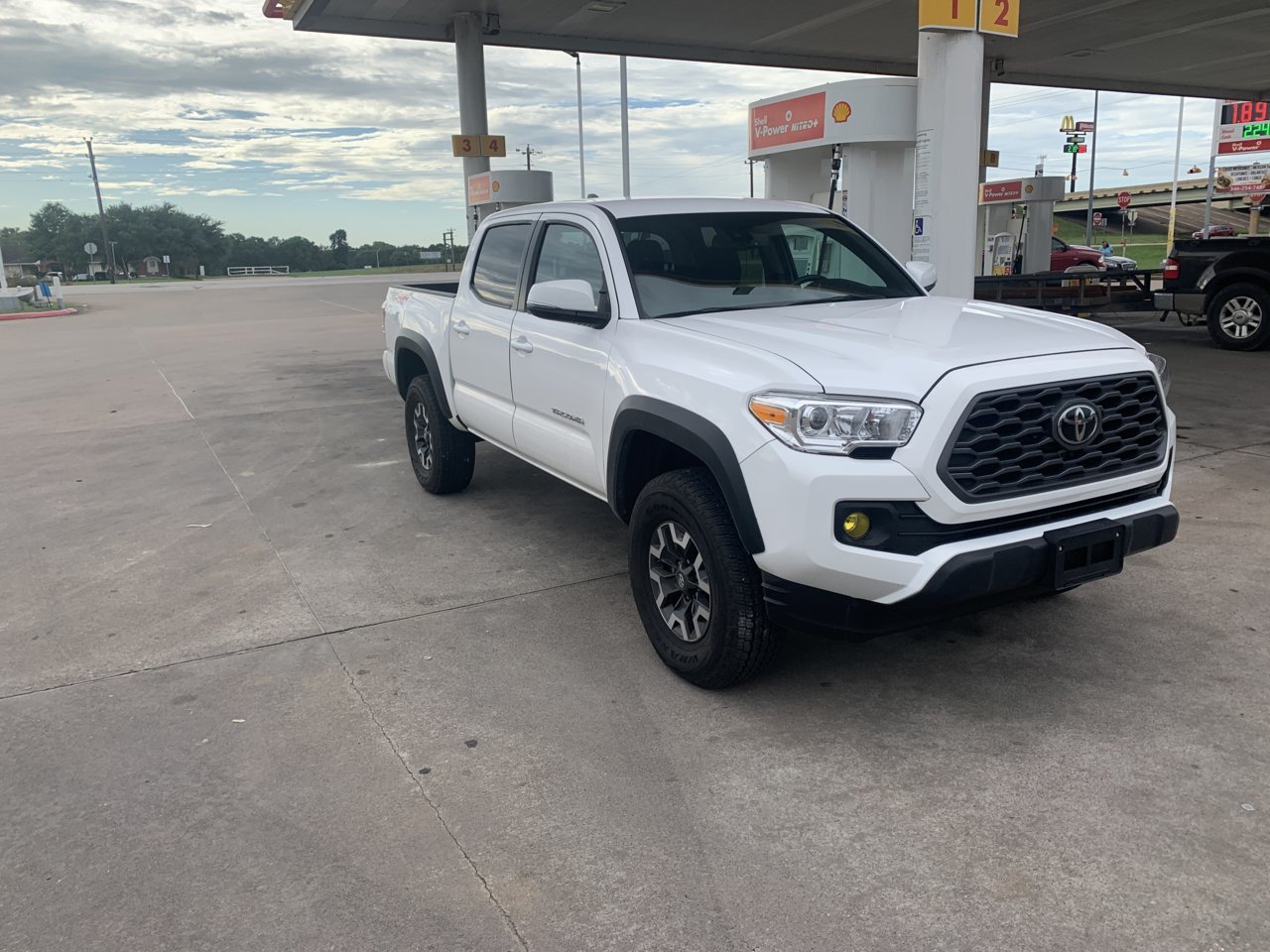

    Headlight is wrong, there should be black around the side reflector.

    Yep this one has been in a front end wreck and a decent one at that from the parts you've listed. Theyre commonly broken on good front end hits from my personal experience

    check the front reinforcement bar behind the bumper and see if the nuts show signs of being messed with. Some pics of the frame and apron assembly might be good too

    Bumper is wrong too, it has the air dam. The off road doesn't have an air dam.
