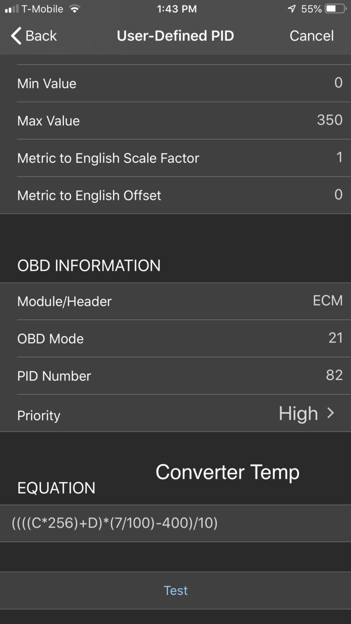

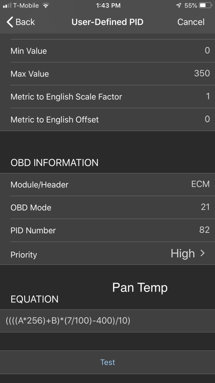

    60A35D72-B0E4-4DF3-B7C3-EF09E338F605.jpg BF4B2ED9-C577-4133-B1FA-002F35745681.jpg There’s a few apps. Just get a blue tooth reader. Mines a kiwi 3 with a fusion app.
    Wytelytning[OP] and DG92071 like this.

    Edit to add that if you do the OBD2 scanner route and those formulas in the screenshots above don't work; change A,B,C,D to E,F,G,H
