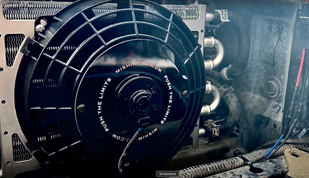

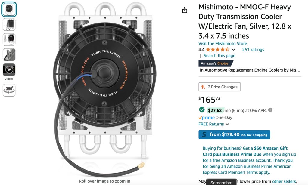

    This is my pick for the best cooler currently. I'm running one for the trans, about to install another for the PS. No fancy brackets here just used the stock mounting bits and pieces. Took some work but got it done.
    https://amzn.to/3MBTUU5
