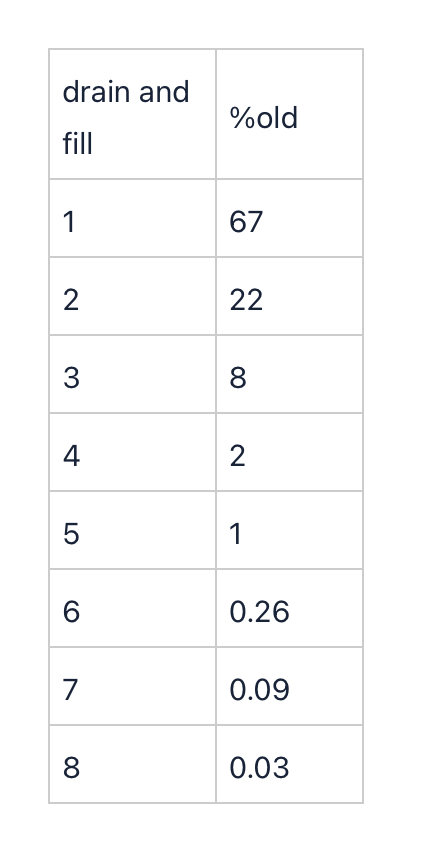

    I’m going to start the process of swapping the ATF. It’s been like 40 years since I’ve had to do differential equations but if doing this right, assuming here is no breakdown in the combination of old and new ATF (read didn’t drain and fill and then go drive the balls off the truck) the biggest improvement in ATF quality when replacing 1/3 of the ATF at a time would be seen in the 2nd and 3rd iterations. After the 5th iteration I’ll have less than 1% of the old ATF remaining and beyond that it’s probably not worth the effort.

    What I tried to show in post 22 was the results in terms of % of old ATF left in the transmission when repeatedly draining two quarts and adding two quarts. I based it on a total capacity of 6 quarts but the A340 hold a little over 7. The results are still basically the same, after you’ve swapped the 3 gallons 2 quarts at a time there’s around 1% of the old ATF left in the transmission.
    So this weekend I’ll take my 3 gallons of MaxLife, drain 2 quarts, add 2 quarts, drive around to get the truck up to normal operating temperature to make sure the new stuff is mixed with the old and then repeat until I’ve swapped all 3 gallons, 2 quarts at a time. I’ll keep the ATF I drain each time in separate containers so we can see the results. If I’m right it should be hard to tell the difference between what I add vs what I drain by the time I’m done.
