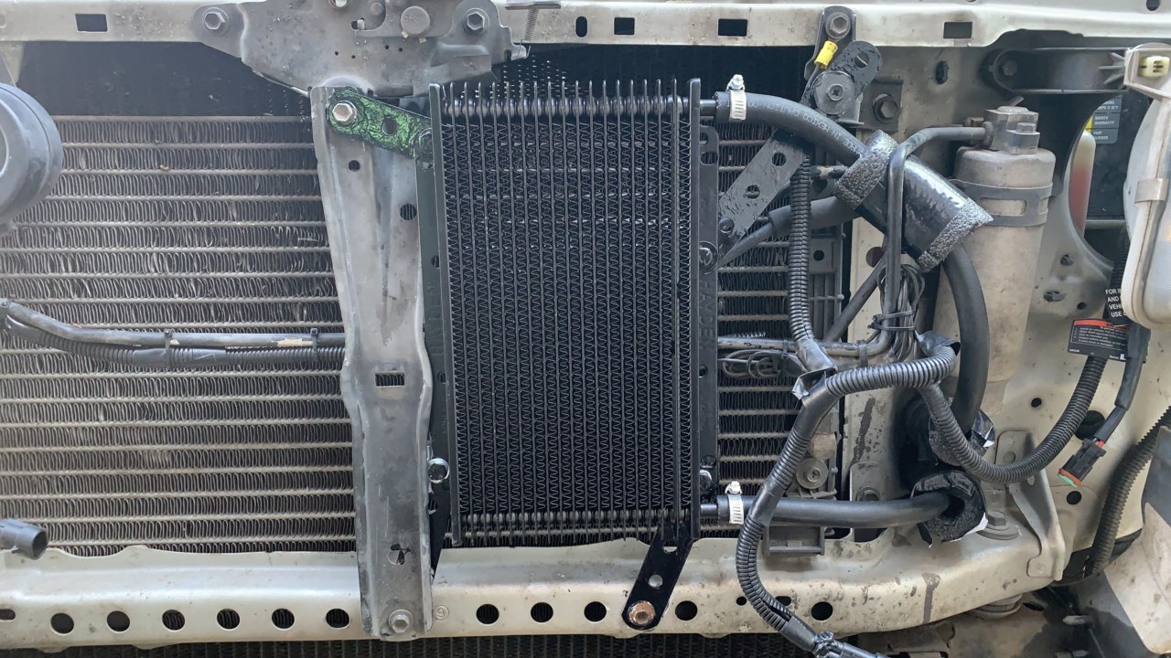

    I installed the Hayden 697 Transmission Cooler with hoses attached horizontally. In from radiator on bottom, and out to transmission on top. @Timmah! mentioned in his video to do it this way so that as the ATF enters the cooler it fills up from the bottom, displacing the air out of the top hose. If it was reversed the air bubbles would potentially get caught in the cooler. I also flushed the transmission oil using the @Timmah! method, added an inline magnetic filter, and replaced the filter in the transmission oil pan. Afterwords my MPG went up from 16.2 to 18.8!
