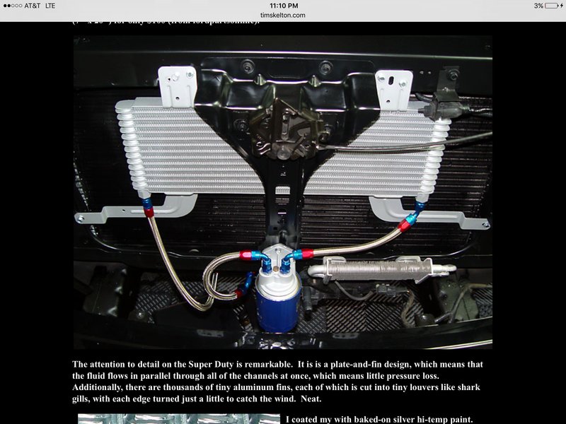

    Maybe someone here can answer a concern I have that doesn't seem to be answered anywhere I have found. When I install a new cooler that uses LPD to only cool the fluid when needed, how do I make sure I get the right level of fluid if the cooler won't fill until it is a higher temp than the fill check temp?
    I'm looking at these 2 coolers that both work that way:
    https://smile.amazon.com/70264-SuperCooler-Automatic-Transmission-Cooler/dp/B000CIIDZE/
    https://smile.amazon.com/gp/product/B005XZXBYE/
    Is it not enough fluid for me to be concerned? Is it ok because the fluid expands as it gets hotter anyway?
    Thanks for any possible answers!

    I installed an extra cooler last spring but never wired up the fan I mounted. A month ago I got stuck in wet sand when I was surf fishing. The temp icon lite up for the first time I let it sit for 5-10 mins before trying to free the truck. What temp does the light come on at?
    I shouldn't have been so lazy and wired the fan up:frusty:

    Your aux cooler my not be flowing correctly if it wasn't installed correctly. See attachment
    I would think that fan not working would only block air from circulating, no?

    It wouldn't open for me but the one I got said it could be mounted in any direction. The intake and return are both on bottom so now I'm second guessing it.image.jpg

    Well that can't be denied I still can see how that would make a difference. Maybe a small air lock at the top but with the fluid being pumped it should purge itself out? If I have anymore temp problems I'll have to flip it. Just didn't want the hoses to pinch shut after they got hot. It wouldn't fit on its side and top was a tight 90 on hoses.

    OK all, so I just installed a new transmission cooler (Derale 52506), did a pan drain and refill and yes the transmission has the correct amount of fluid. I have driven around town and my trans temp was around 165*F, does that sound right, I have also taken the truck on the highway and my trans temp on the highway (doing 70mph), was around 150*F. Does either of those temps sound within reason. I really added the new trans cooler for the purpose of towing my camper (5500lb's). I have not hooked up to the camper yet to take it for a test drive and compare the temps. My trans temp when towing before adding the new cooler would reach 220-260*f. I don't remember what the temps were during normal driving conditions.

    Make sure the hose coming from the radiator is going into the bottom of your Derale cooler. Those temps are running a little higher than mine. When I'm towing my 5000 lbs trailer on level ground at 58 mph on a 100 degree day mine runs 155 degrees. Around town mine hardly ever get above 140 now.

    Ok I will check. I didn't think it mattered what hose went where. That's the info I got from the manufacturer (Derale). So what you are suggesting is the hose coming from the radiator goes to the bottom of the cooler and the top of the cooler is the return to the transmission.
