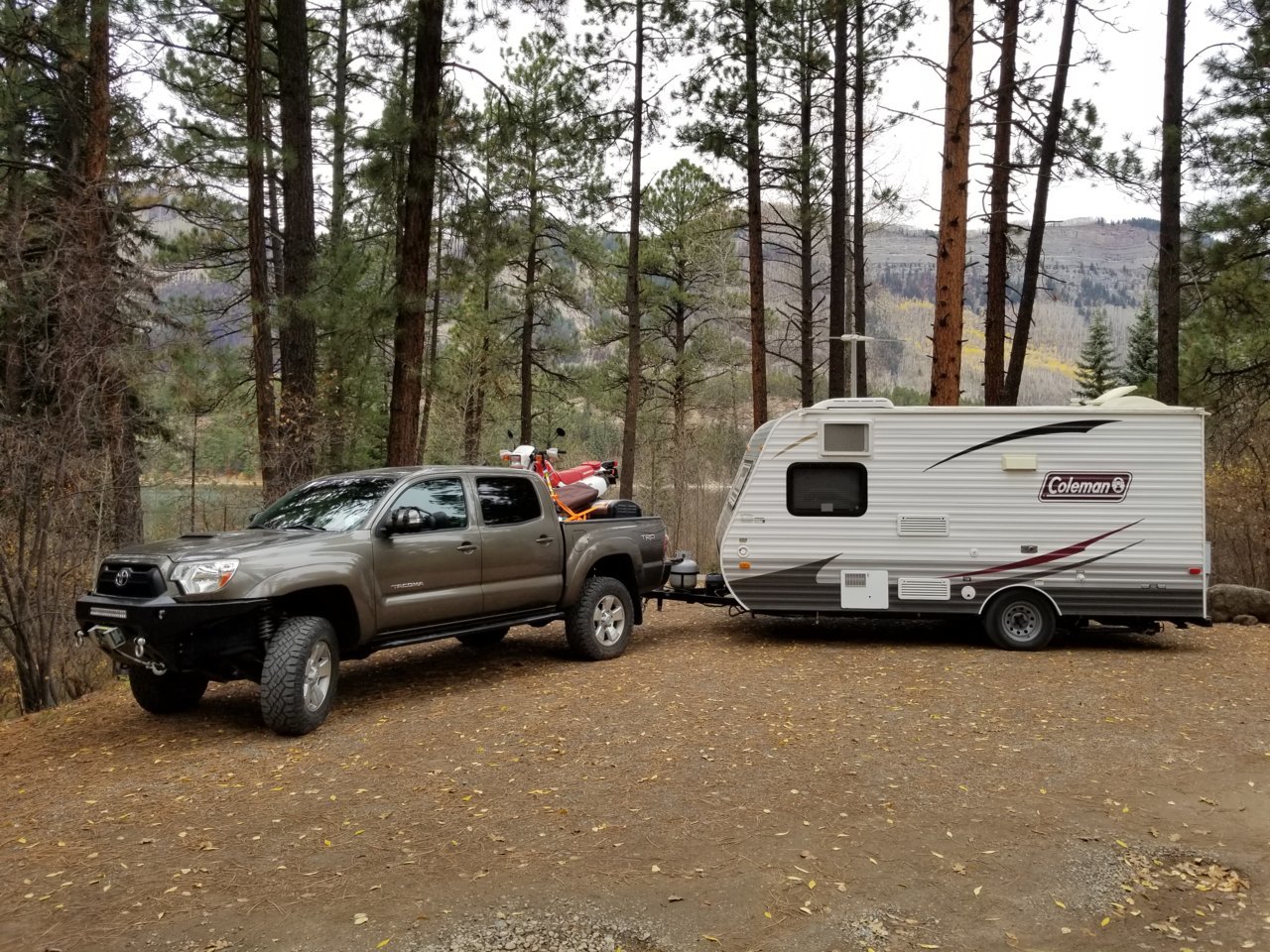

    I'd like to know as well, as I'm in the opposite boat. Question should probably be: Do you have a trans temp guage? If you did, you would probably have seen how hot it gets.
    I don't pull super heavy loads, no more than 1000lbs and I can get the temps over 220 easily going uphill. I've also had to shut down to cool off while off roading.
    I initially put in a stacked plate cooler, but that didn't cut it off road at low speeds and would still get the transmission hot on some mountain passes. I'm currently running the largest remote cooler with it's own fan and shroud I could fit on the truck and I don't have issues anymore. It's a
    Derale 15960 Hyper-Cool Remote Engine/Transmission Cooler
    Some with run without a gauge per above and say that they didn't have any issues. However, none of the above state they have a temp gauge. So, their transmission has not failed them yet, but running higher temps significantly shortens the life of your transmission. I hate the costs and lack of reliability of an automatic transmission, so to me, a cooler is very cheap piece of mind for a transmission which will cost thousands to replace when it leaves you stranded in the middle of nowhere.
    Edit: More notes on remote cooler install:
    No pics and it's 12 degrees outside right now. Mounting the cooler, I used metal bar, angle grinder with cutoff wheel, drill and bolted it. Mine is currently in the passenger side rear fender in front of the tire. I will probably be moving it under the bed soon, as the fender gets hot and my rock sliders I'm installing are going to lock it in there.
    Figuring out lines was the hard part. There is a cooler line output and return from the transmission to the radiator. I left the output intact and rerouted the return. I found where the return hard line attaches to 3/8 rubber hose in the passenger front engine compartment. I used a 3/8 to 1/2 barb adapter and ran 1/2 hose to the cooler and then back to the transmission.
    At the transmission I used a M14 x1.5mm to 8AN adapter to plug the hose back into the transmission, it's a little tight here and I needed a short AN8 elbow to avoid getting close to the exhaust. The cooler is nice and has a thermostat that kicks on at 185, it never gets much above that.
    Additionally, I removed my passive cooler from in front of the radiator as having more than 1 cooler impedes flow, and with the huge remote setup, I don't need it blocking my evap and radiator.
