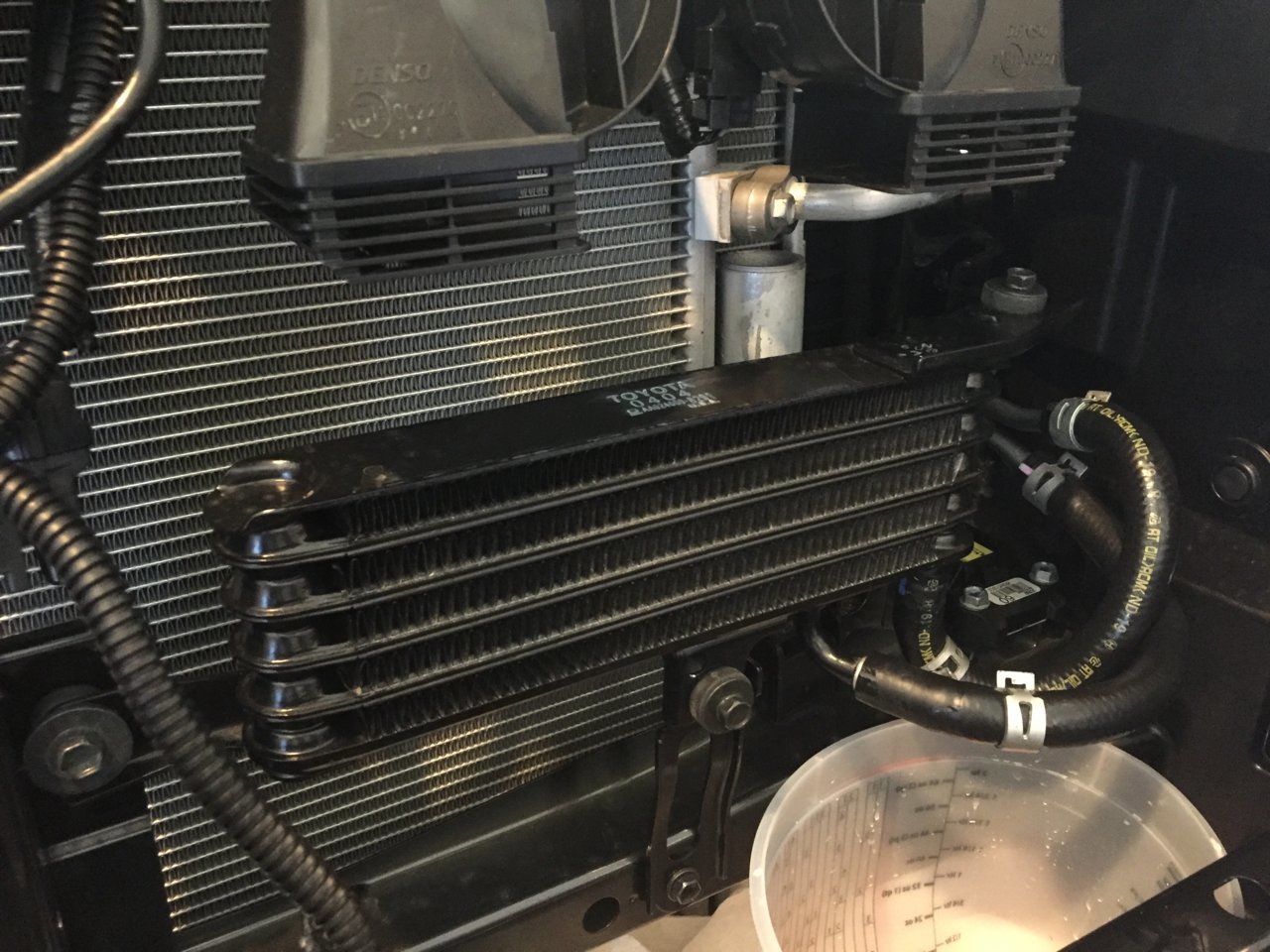

    As said. A Tru Cool stacked plate cooler is a good choice.
    Some Tacoma owners have overheated their trucks while crawling around in the desert.
    As the transmission has a thermostat, more cooling capacity to prevent high temperatures or transmission overheating never hurts.
    CD6577AA-2787-4BD7-8115-89664DFC0576.jpg Tru Cool 4589 stacked plate cooler. A 4590 will also fit.FCA05B1C-64F3-417B-9D12-73E135AF8486.jpg Stock cooler.B17D45C1-9266-477D-ACAC-59091082A85C.jpg

    Advice - DO NOT purchase from an On-Line supplier and be weary of Tru-Cool. Buy it local so you can return it if it is bad. I bought the Tru-Cool LPD 4590 on line - looked perfect visually. Installed with no issues. Fired up the truck and found the TRU-Cool had a bad core. Pissing ATF all over the place. What a mess. So I went down to the local Auto Parts store and bought a Hayden 679. Installed it with no issues. No leaks. Tru-Cool has a good reputation - but they were purchased by another mega parts company - then they began expanding manufacturing - they are no longer made solely in the USA or Canada - they do not pressure test each unit manufactured - they do not give a shit about quality control. Hayden tests every cooler they manufacturer before they leave the plant or are shipped. I really thought the Tru-Cool was a quality product - but they are not. I got my purchase price back and the seller got their unit back - probably to throw over the border fence so it could be re-packaged and sold again. If you have the tow package connect the additional cooler is series (the outlet from the oem tow cooler becomes the inlet to the additional, and the outlet from the additional cooler becomes the return to the transmission) by removing the top hose where it comes through the radiator to the oem tow cooler. GL.
