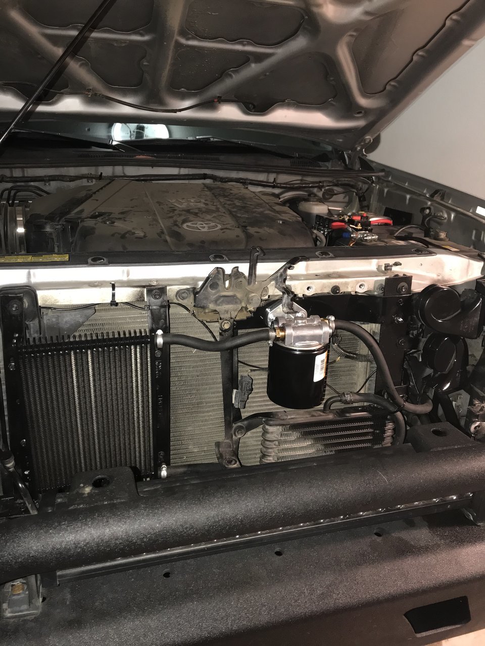

    Is it better for hot atf to go from bottom of cooler to the the top? Or from top to bottom??

    It doesnt matter . The fluid is being pushed by the transmission pump and will go either way just as easy

    Why would you not put it online with the oem transmission cooler my truck runs areound 150 now pan temp. Everyone I know goes inline. There’s no reason not to

    My set up...works great

    Thread revival. And details on filter set up? Make and model?
