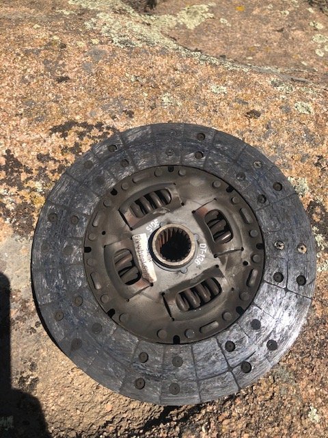

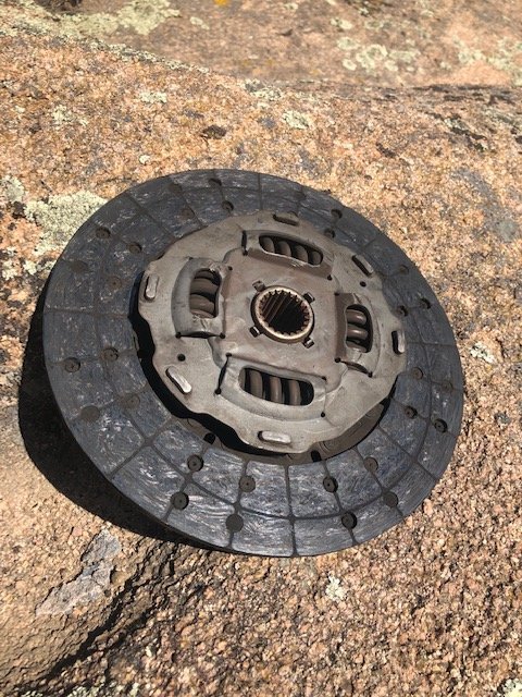

    Well, Clutch is about done but not down to rivets or showing loss of material.
    Gotta decide what next! Have a spare tranny but wish I knew how good it is.

    That sucks, guessing that means the synchros are shot?

    Don't know what's in there but I would guess more than syncs. It went into gear just fine - wouldn't move.
    Gotta figure out what I unbolt to see the "pieces"
