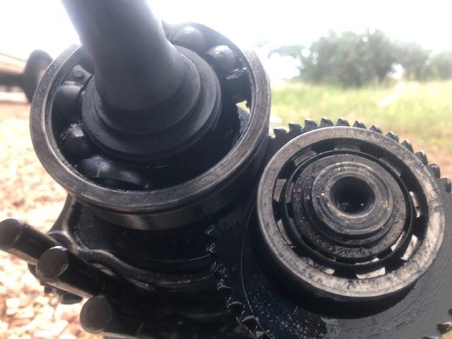

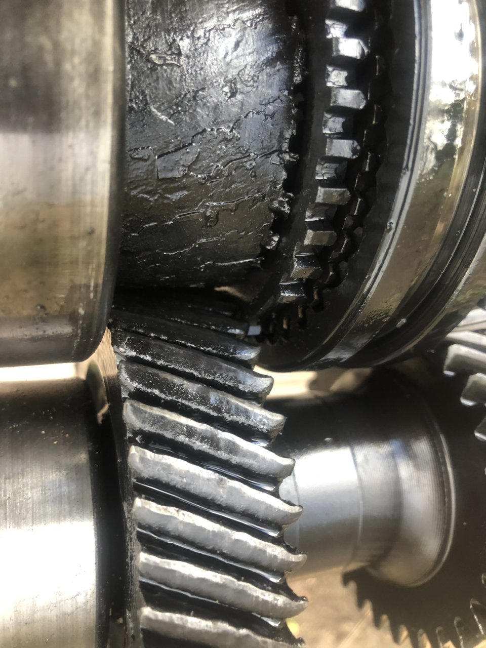

    I think I now know what was/is wrong, though not why. Supposed to be balls all around a bearing? And teeth in this void?IMG_0243.jpg IMG_0245.jpg

    What shaft is that bearing on?

    Ouch. Yes the bearing should have balls all the way around and teeth on the gear.

    Thought so.

    Looks like the bearing on the shaft siezed and so did the shaft, and then that stripped all the teeth of the same shaft?

    Who knows? Just noticed the input shaft turned way too easy (in every gear but 4th), and there was a lot of scrap metal everywhere......bearing was not seized when I pulled stuff apart but may have been early in the game.

    Bearing is definitely bad. Not an expert, but it looks like a tone ring to the right of the second pic so there is a small chance there aren't supposed to be gear teeth there, wipe the grease away and it should be obvious if they were sheared off.
    Edit: Sorry, just finished reading the whole thread and it would make sense that they sheared off and hence you can only use 4th. Good luck to ya OP, curious how this turns out.

    Thanks for reply Tacos and all. You can feel the "roots" of the teeth in the grease, and ain't much grease there - more like fretted metal looking like grease. Seems you can also see a tiny bit of the teeth on each end of the "blank". Didn't actually find the missing balls, but lots of bearing cage material! Surprised it wasn't screaming, but maybe radio on high. On to installing my spare tranny I guess.

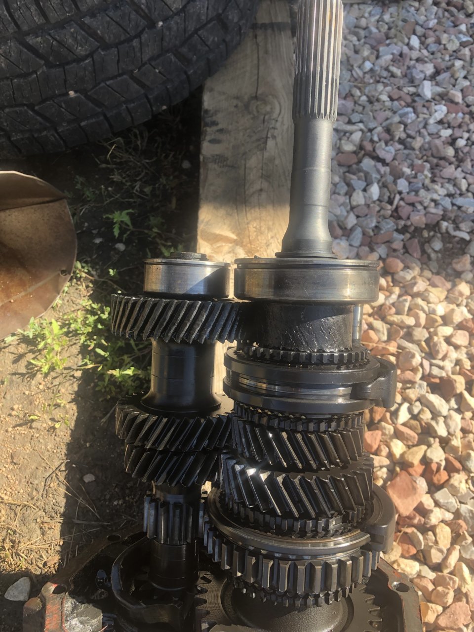

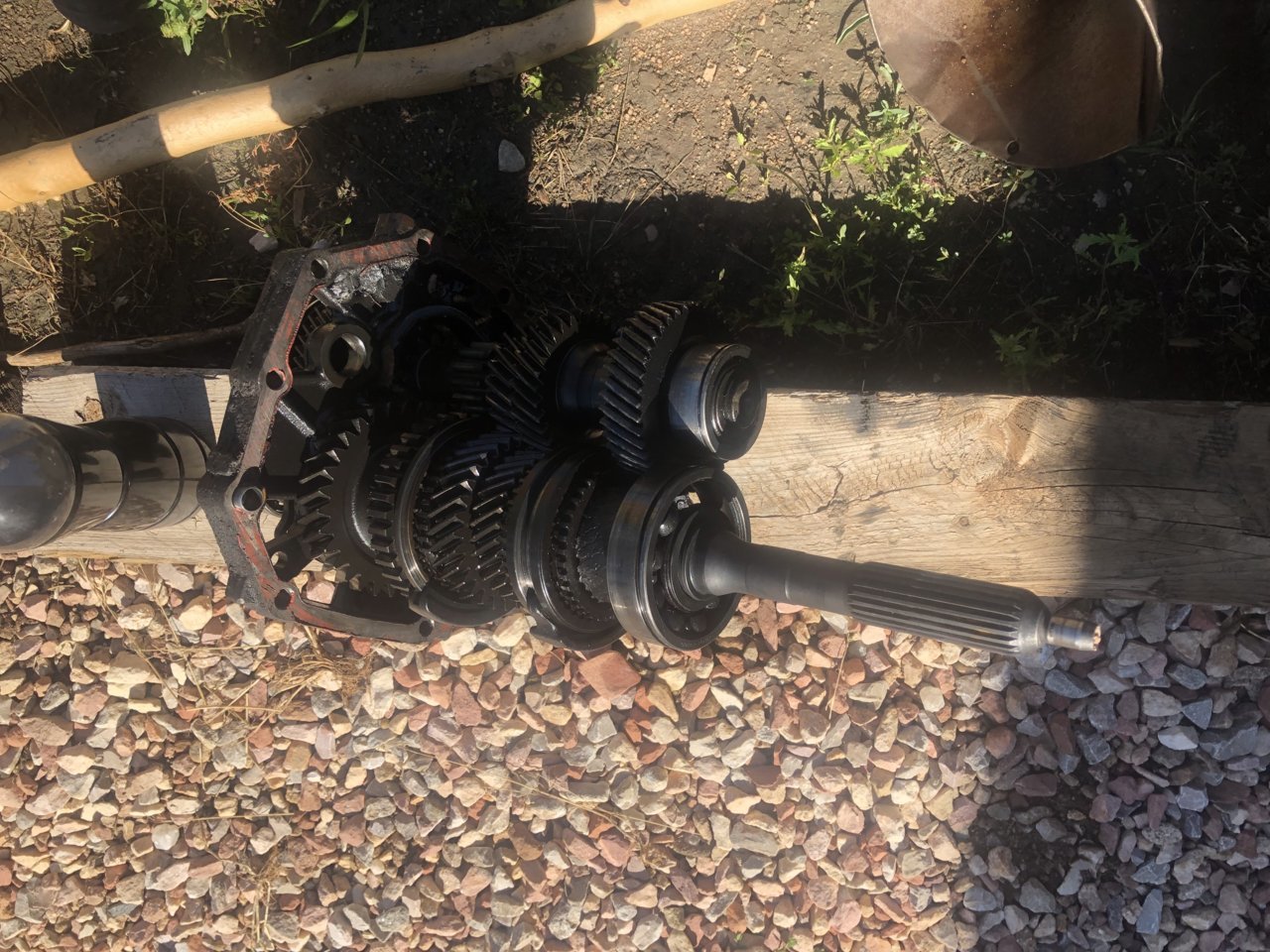

    Seeing where your at with this and what happened inside has definitely speed up my tranny swap time line. Thanks for the pictures. Also for reference I called a local shop yesterday they quoted me $1,000 to rebuild a w59 already off the truck.

    Tour991 - missed your question. Main input shaft I'd call it......

    I don't know terminology, but is shaft that clutch disk goes on

    Yep, input shaft. I think you win the award for the most damaged 5 speed.

    That is in fact the input shaft. Cool. Well it's always good to get to the bottom of it.

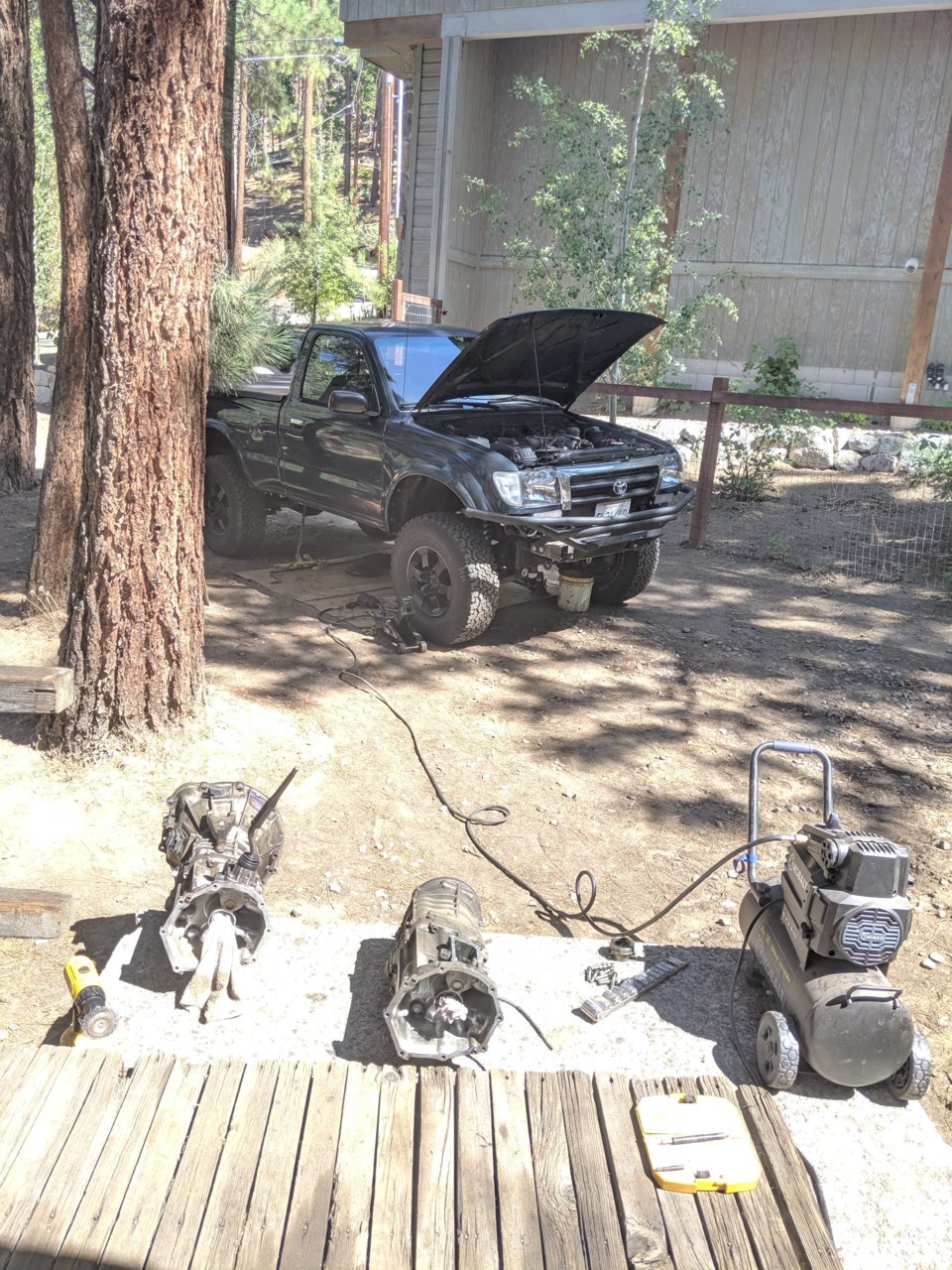

    Nailed it!!! I think after I swap mine I'm going to pull apart my whining one and see if I can rebuild it.

    Swapping my trans out today, I'm going to crack open the old noise one and compare to the pictures op posted.
