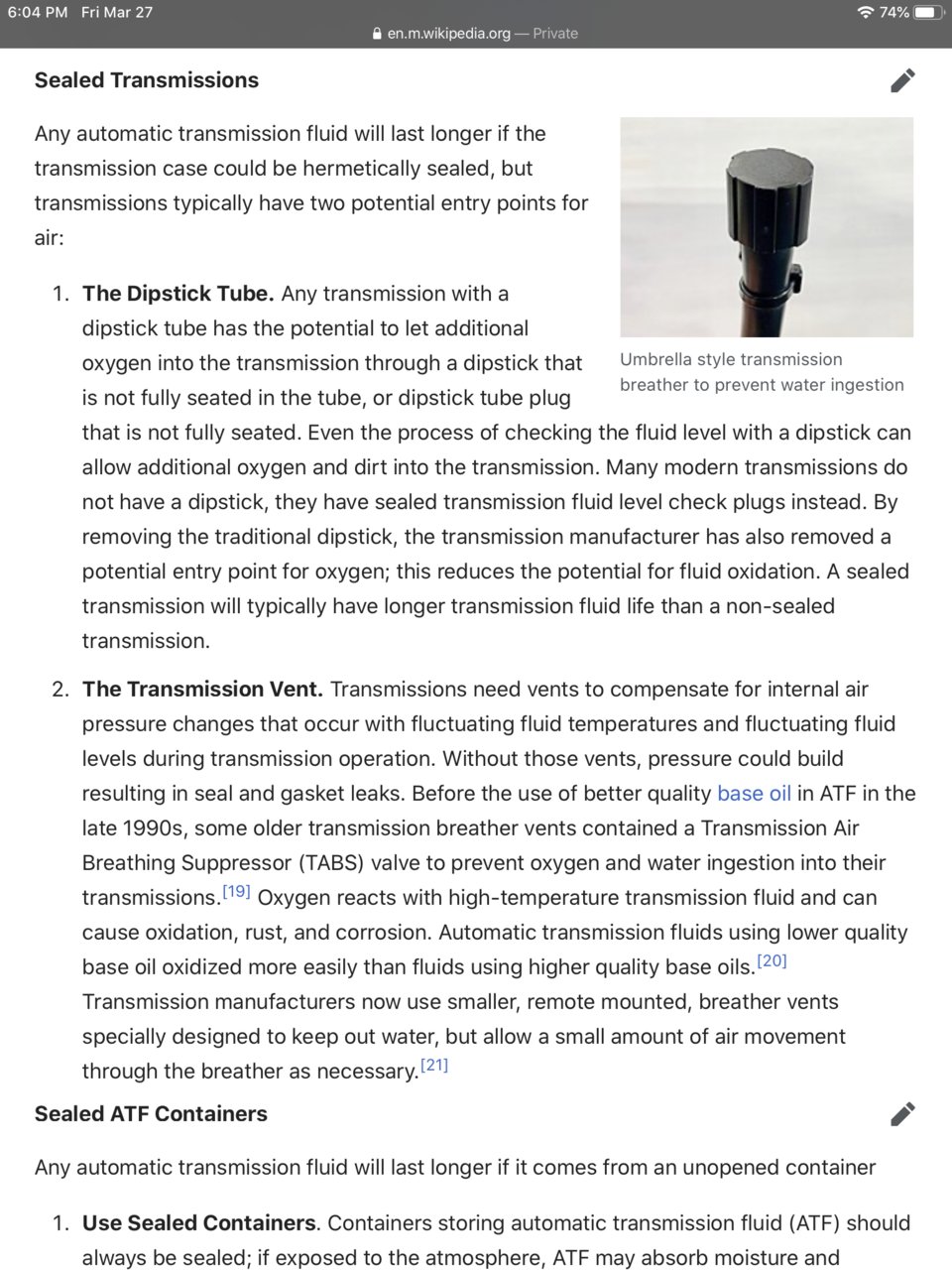

    The Wikipedia article I quoted touches on the subject. It used to require a special type of breather. On modern cars it appears they just look to restrict breather airflow to an absolute minimum. I know there is a phenomena in some systems where the breather has a hose and you are basically just moving the air in the hose back and forth during heating and cooling. I’m not sure if Toyota’s AT breather is at the end of a hose or not.

    Ok. I really don’t think you understand what the automakers are trying to do with the sealed transmissions that are a feature on their most reliable vehicles: To make the majority of transmissions, in normal use, last longer, by preventing oxidization of the fluid.
    If you take the time to read the wiki article, you will come to understand that there is a specific issue with Automatic tranny fluid and oxidization. Like brake fluid, it should never be stored in an open container. Or you could still keep arguing some inane point about cost savings by removing a $3 dipstick.
    Toyota ditched the dipstick decades ago for good reason as have others. I’d like to have one on my truck, but at the same time understand I’m not your average owner. The average owner just wants blind reliability.
