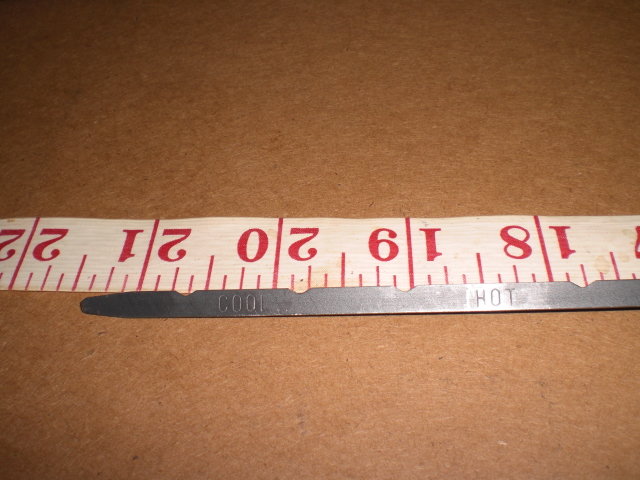

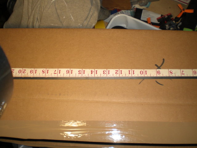

    Hello, can someone with an auto ‘98 2.7l 4x4 please provide measurements for the transmission dipstick? Searched high and low for the correct dipstick, come to find out Toyota discontinued them :mad: so i’m resorting to making my own :)
    If you could provide the total length, bottom to the top of the “cold” level, and bottom to the top of the “hot” level marks, or just all 4 markings lol. Thanks in advance!

    Upon further research, that p/n belongs to any auto 4 cylinder 4x4 between 98-02. Not sure why it changes for 03-04 since the only difference should be the the electronic drive-by wire but still the same internals and oil pan.
    Anyone with a 98-02 4-cyl 4x4 care to chime in? Help would be very much appreciated :)

    No that is a Rwd.....A43D transmission....

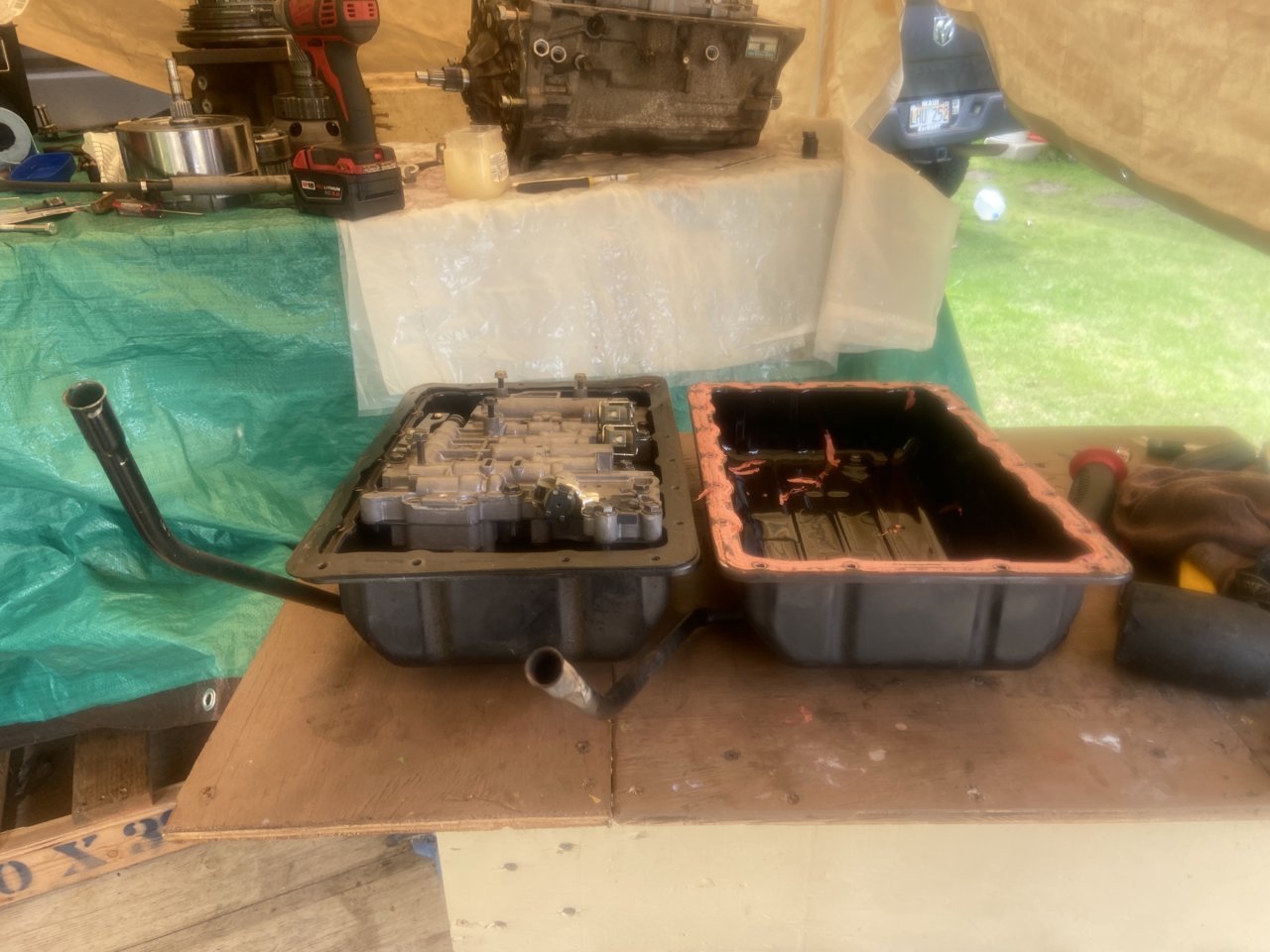

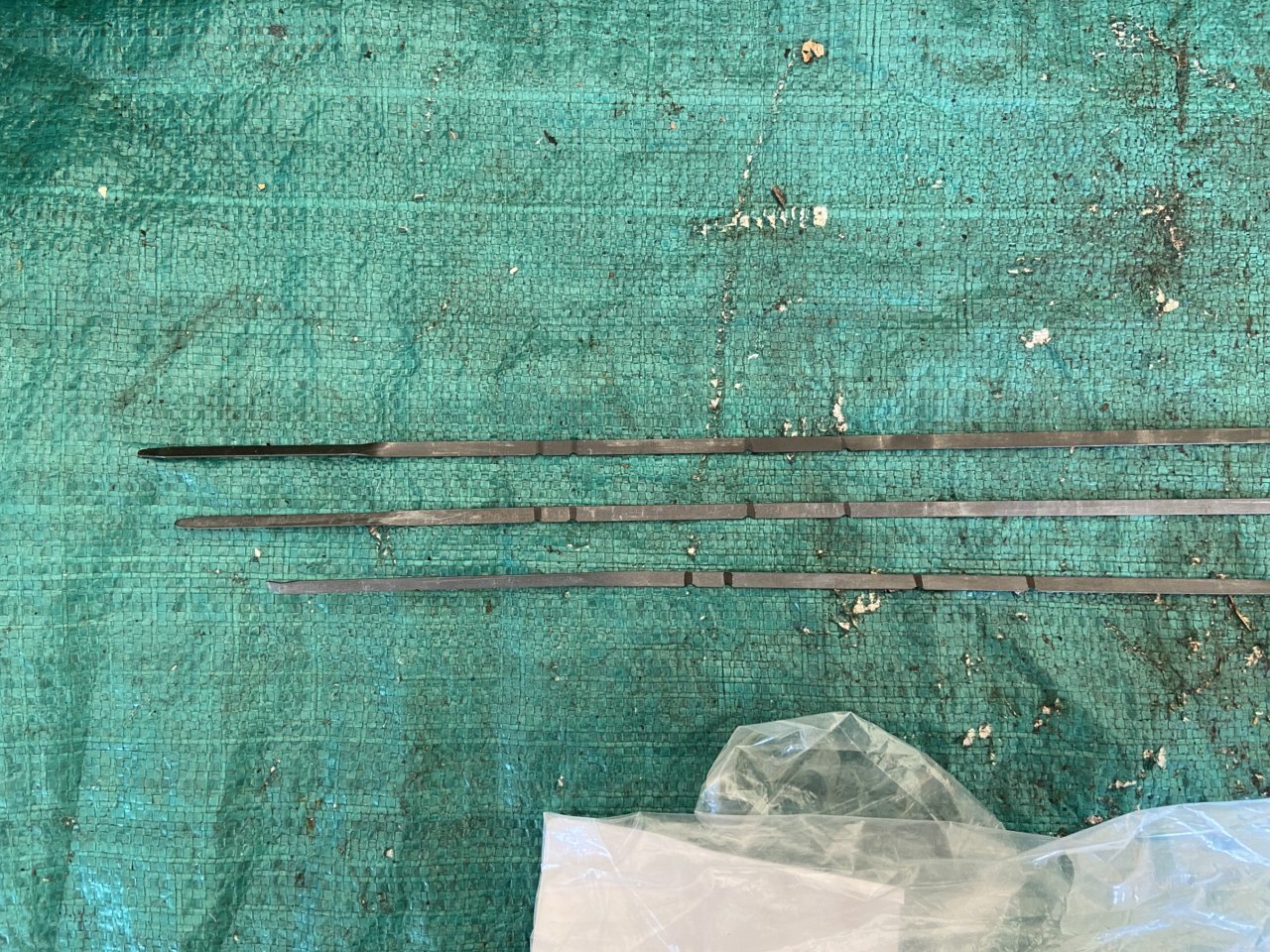

    Update: Did some shopping!

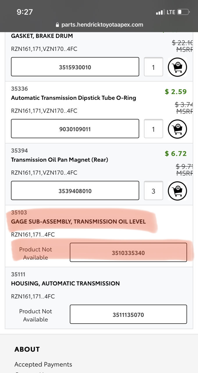

    The premise: I did a 4wd swap to my 02 2.7l DC prerunner but didnt remember to pull the transmission dipstick. Thought it was no big deal until i found out they don’t sell them anymore:annoyed:.

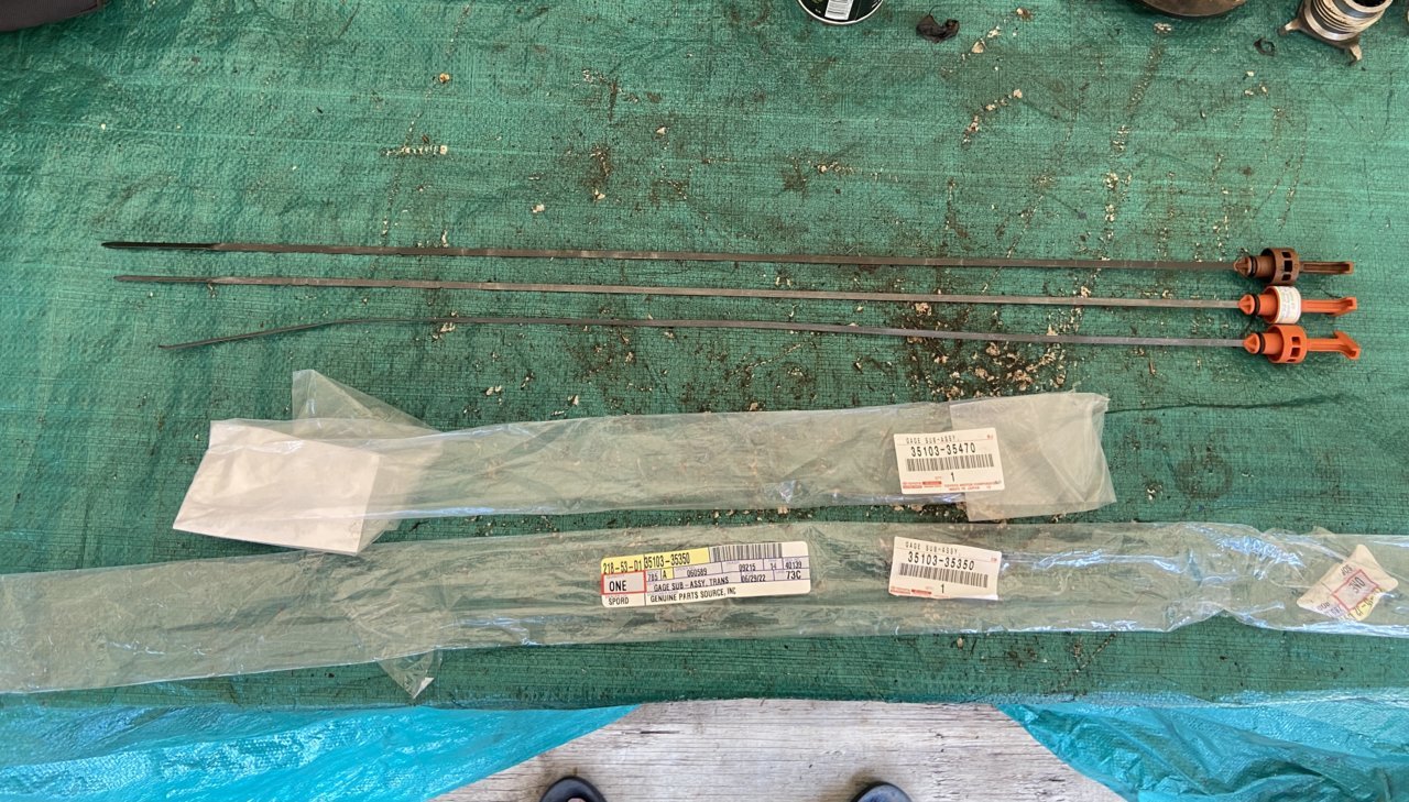

    So, because Toyota discontinued the transmission dipsticks or “gage sub-assembly” for any 98-02 4wd with the 2.7l engine, I decided to buy two other ~similar~ dipsticks to see their compatibility and their differences.
    I ordered gage-assembly pn: 35103-35470 which belong to 03-04 2.7l 4wd tacoma. For some reason it’s a different pn for the 03-04, idk why.
    and I ordered pn: 35103-35350 which belong to 98-02 3.4l 4wd tacoma
    In this photo, lined up from top to bottom, is a 2wd dipstick that came with my 2002 DC prerunner, the 03-04 2.7l 4wd dipstick is in the middle, and a 98-02 3.4l 4wd dipstick on the bottom.
    A closer look shows the 3.4l dipstick is definitely not the right dipstick. Interestingly enough (at least to me), the markings on the 03-04 4wd dipstick is in the same position as the prerunner dipstick when measuring from the top.

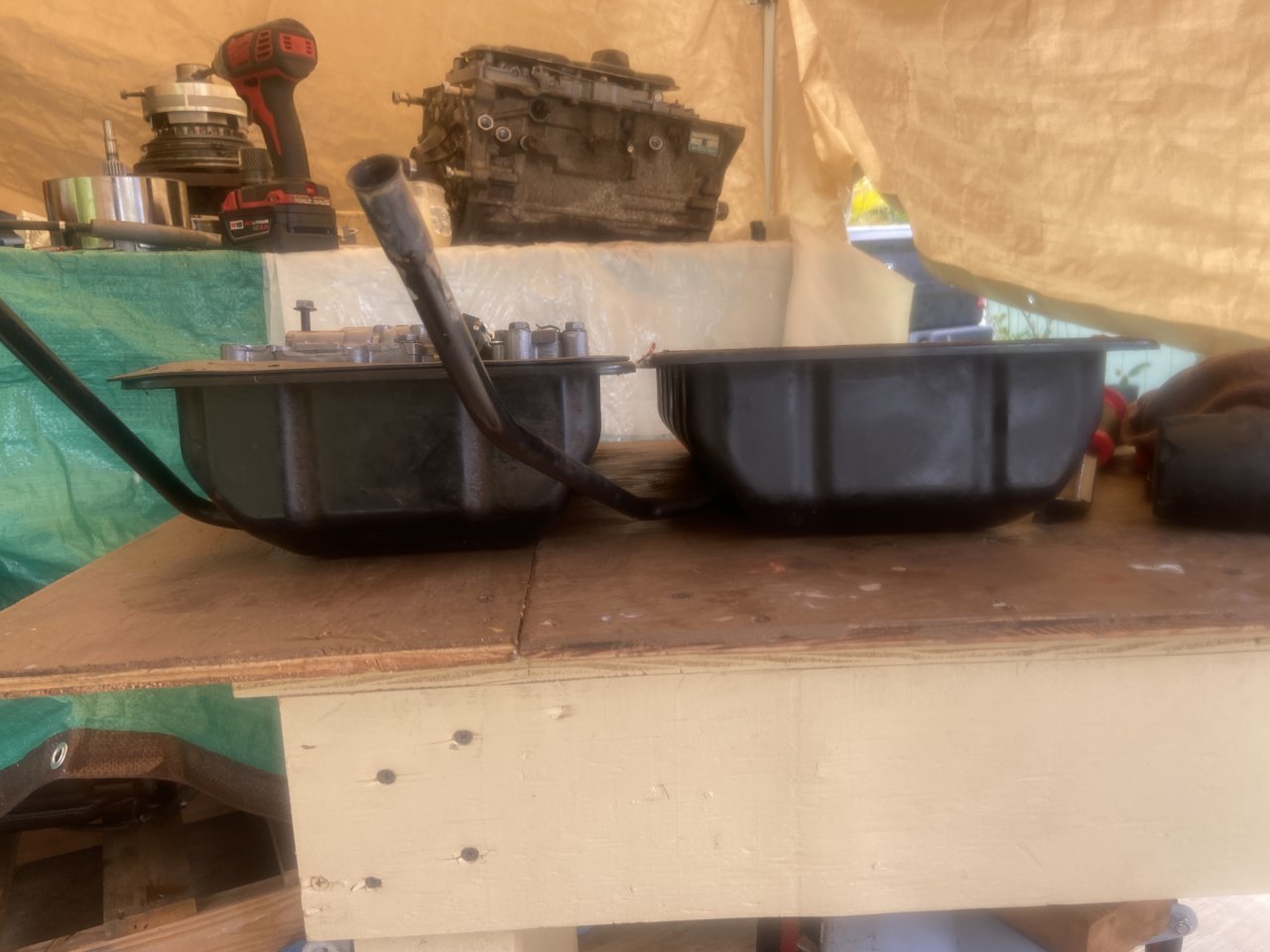

    I should note that my prerunner pan on the left looks to be the same size as the 4wd pan on the right, which in retrospect makes a lot of sense as to why the top two dipsticks are almost exact in length.
    So, although toyota discontinued the correct dipstick that I need, it’s safe to assume that the 03-04 2.7l 4wd dipstick will work, and reusing the 2wd dipstick (assuming the pans are similar in size) is a safe option as well.
    But huge thanks to everyone that tried to help!
