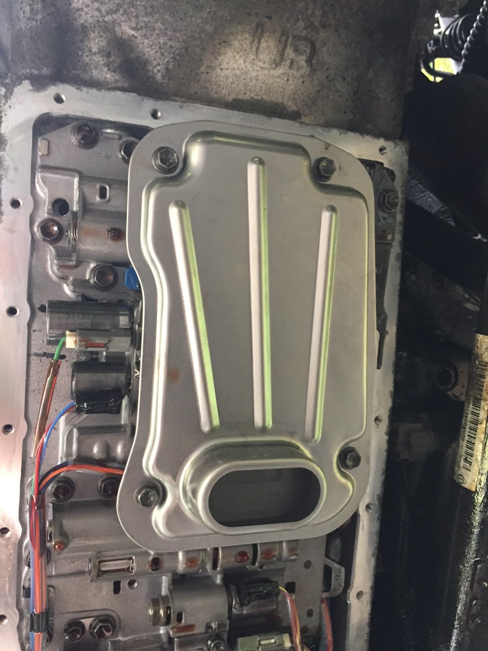

    I've seen the write-up for the regular transmission flush. Is there one that covers the pan drop and filter cleaning by chance?

    Can't help but if you have a write up for the regular drain and fill the only extra work is to unbolt the empty pan, then clean off the magnets, maybe add some extra ones (optional) and clean the filter that will be obvious when the pan is off.
    Then reinstall and follow the rest of the write up

    Hell, if you’re going as far as to drop the pan, might as well pull the valve body. You’ll get a bunch more fluid that way and it’s pretty easy to do.

    When I put the IPT valve body in my trans, I asked John (the guy in the video) about doing a full fluid change at the same time.
    His words were “when you pull the valve body you get almost everything anyway. Don’t worry about that”

    You need a new gasket if pan is dropped. Count bolts in the pan. There’s a 19 and a 20 bolt pan and they use different filters and gaskets. New filter is $20 just replace it.
