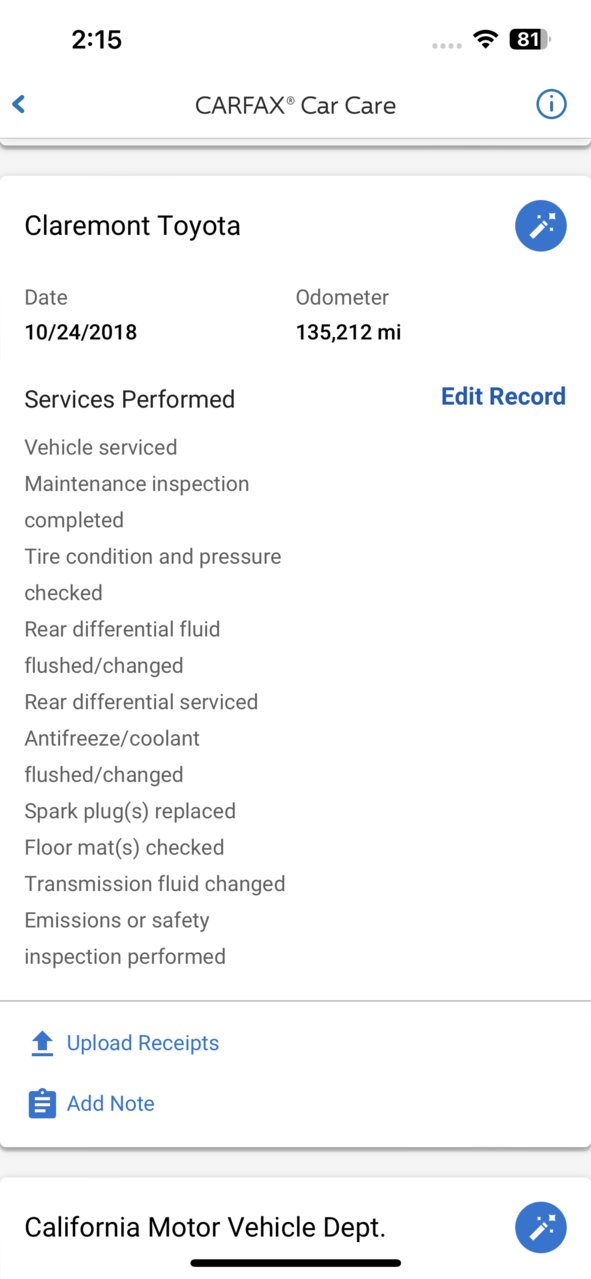

    Any recommendations on either Full Flush or just Drain & Fill. Currently my Truck has 168,520 miles and I’m the second owner.
    Here is a picture of the CarFax and it’s maintenance done at the Dealership from the 1st ownerD949D566-FFAF-4FAB-BCE5-8BFDBB723817.jpg

    Here’s my take:
    Any vehicle I buy second hand gets a complete work over -fluids, brakes, grease, belt, everything. I make a list and just starting going through it.
    If you are going to the trouble of changing the trans fluid you might as well swap it all out, it only takes a minor amount of extra effort.
