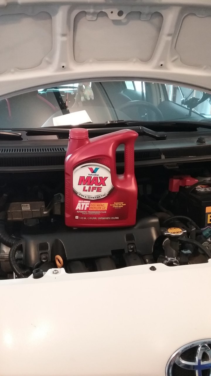

    Maxlife is an economical way to go. $18 for a 4 quart jug at Walmart. I've had nothing but good results with it. Been using it for sometime in several high mileage Toyotas in the family.

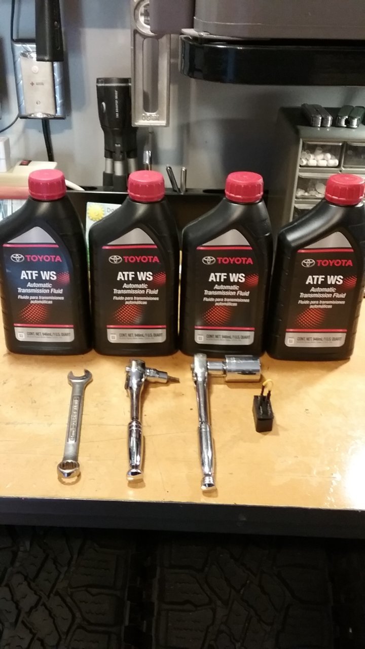

    But if you're willing to pay the price, you can't go wrong with WS. In my area it retails for about $10 a quart. I was able to to get it from my local dealer for $7.75.

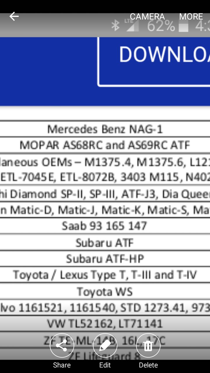

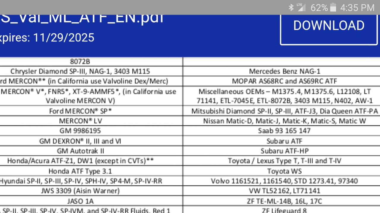

    OP has the 2.7, so the WS type ATF is not relevant. and the video refers to the A750 as well. the 2.7 uses Type IV fluid and has a dipstick for checking the level

    Oops. I stand corrected. Forgot about the 2.7 having a different fluid. But Maxlife still applies.

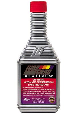

    I did the 3qt drain and added this stuff..
    Lubegard 63010 Platinum Universal ATF Protectant, 10 oz.
    When i do end up flushing the entire system, i will continue to use the Lubeguard stuff too. I'm at 205k mi with absolutely 0 issues and my transmission should be failing by now with some of the dumb shit i've done.. such as going up sand dunes 100% throttle in 4wd and the truck rolling to a stop while still 100% throttle
