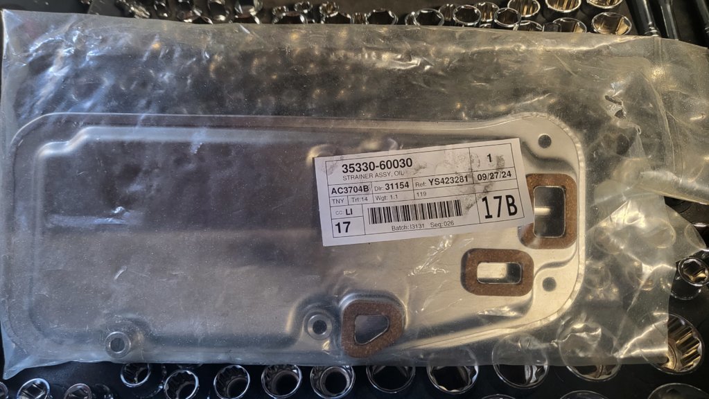

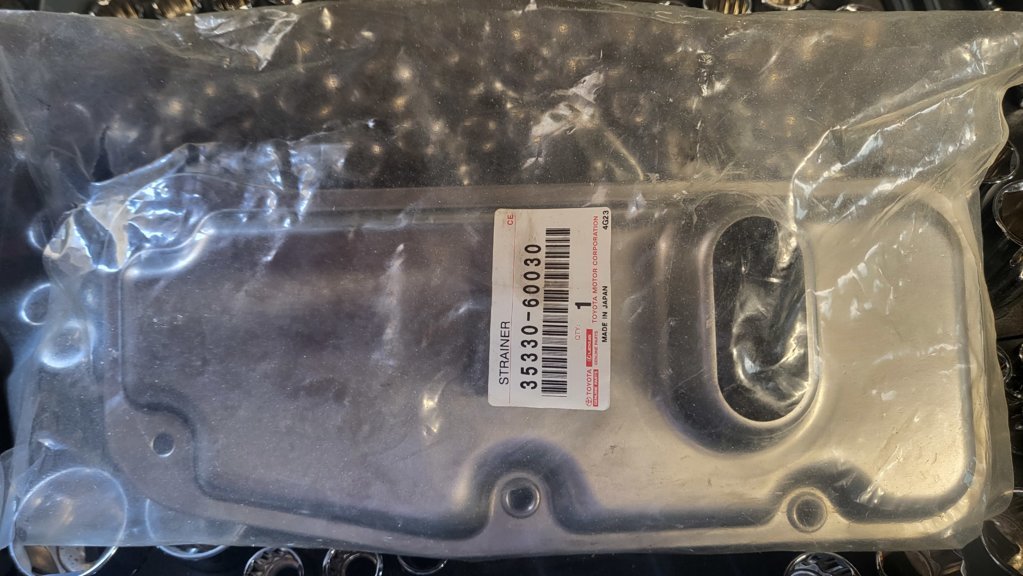

    Circling back to close off this thread with an update.
    Someone seemed to have have been in there(transmission case via pan area).
    The bolts were all torque differently as I was taking them off and I found trace red rtv along the mating area of the transmission case that meets the pan gasket. The transmission filter was also a bare metal aluminum case rather than the dark gray color finish that I would have expected.
    I realized the filter that I bought from toyota(that indicated was the correct part based on my VIN) was actually a different filter than what I actually needed to replace.
    So I ended up not changing the filter.
    Glad this is over and I don't have to worry about my transmission until it's next service.
    Relatively easy fix if you have all the right tools. Thanks for the help everyone. I'll look forward to the feedback about getting the wrong filter lmao

  9. Jul 4, 2025 at 1:30 PM
    #29
    tak1313
    tak1313 Well-Known Member
    Aug 24, 2020
    #338673
    717
    2013 Base 2WD
    Good to hear that it's done. I THINK the pan is placed with sealant from the factory. Of course, some use sealant as when doing it DIY as well, but if it wasn't stuck with sealant, someone was definitely in there before.

  10. Jul 4, 2025 at 1:43 PM
    #30
    Buenotaco2012
    Buenotaco2012 [OP] Well-Known Member
    Nov 7, 2024
    #460227
    46
    Bueno
    NYC til they bury me
    2012 Crew Cab TRD Sport
    ARE Bed cap
    Yeh definitely wasn't stuck with sealant. Only the rear edge of the transmission case meeting the pan gasket had a smear going across the meeting surface. If anything I'll change to the correct filter eventually
