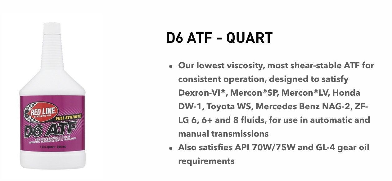

    I've always been a fan of Redline. They now have D6 ATF (Toyota WS).
    https://www.redlineoil.com/d6-atf

    I can’t quite help but being suspicious of these claims of “swiss army knife” oil. I agree Redline is a quality brand, but this stuff seems like one of those restaurants that does Sushi, Pizza, Burgers, Chinese, Tacos, Greek etc, and none of them well.
    How can it be all these things in one bottle?

    Just has to meet the specs. I'm more into changing diffs and trans to redline and never changing again. Crazy enough, I'll bet many owners never change their diff or trans fluids from factory.
    Stocklocker[QUOTED] likes this.
