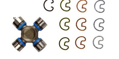

    I saw these, but says for off road use

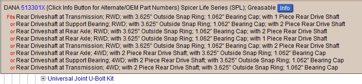

    The number I gave you is for heavier duty U-joints.....nothing specific for On or Off road.
    For '07

    Thank you. I was trying to show a joint that had a greaseable fitting at the end of all 4 caps, not just one.
    It's called spicer extreme and was wondering if they made a non-off road version.

    One grease zerk is enough.

    You can purchase u joints with a grease zerk directly on one of the end caps that will work great for flushing the old grease from the other 3 caps .
    It's easier to acsses than a grease zerk on the trunnion cross
