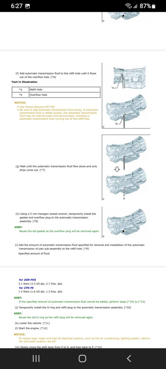

    Are you doing the drain when cool and then replace the same amount that came out method OR the do the drain and fills and then do the wire temperature method?

    Drain cool 2.5 qts approx.
    Fill with 4 qts cool.
    Do shift sequence
    Heat to 105
    Keep motor running
    Use fill plug to drain 1.5 qts and get to proper level.
    this way I get a bit more new fluid in and I don’t have partially filled new fluid containers.
  5. Aug 12, 2022 at 7:02 PM
    #45
    mquibble
    mquibble Well-Known Member
    Dec 26, 2020
    #350714
    1,603
    Michael
    2021 TacomaTRD Pro
    I think you might have a typo.
    the transmission has 3 plugs.
    1. Drain
    2. Fill, this plug is up on the passenger side of the transmission
    3. Check
    Its the check plug that is used to set the fluid at the proper level. This plug has a vertical tube that bleed off overfilled fluid while the truck is at temperature.

    You’re correct. I use “check” plug to drain down to proper level.

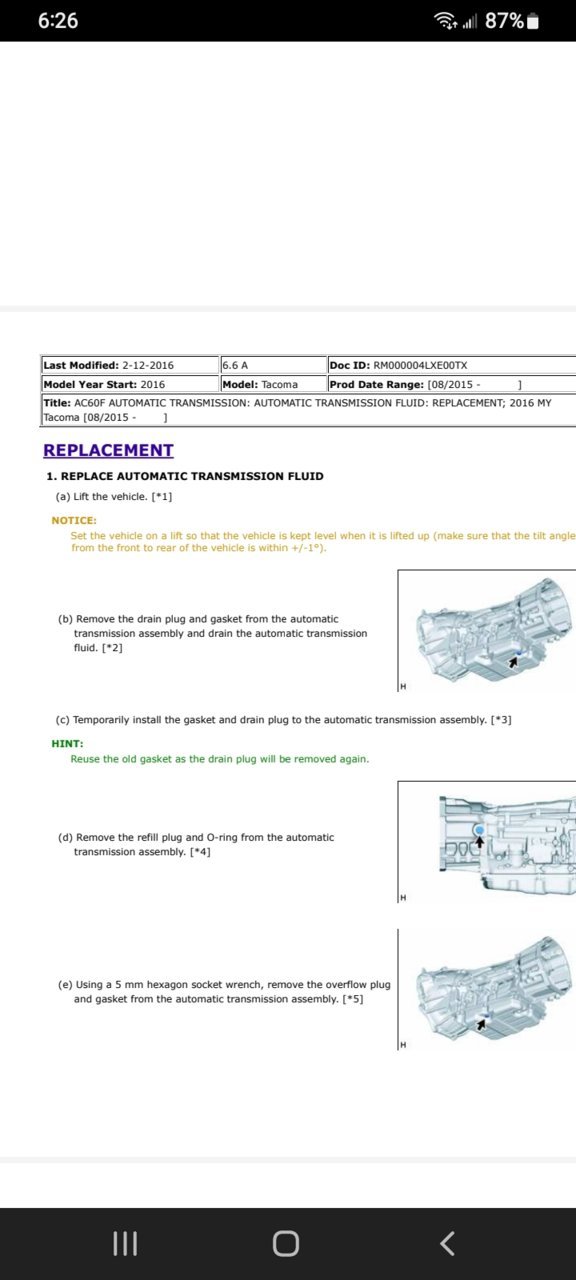

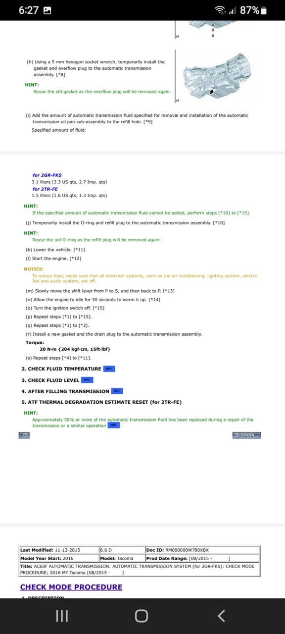

    I just have the documentation that came with the truck, I guess it's not in there right? If it isn't can you link me to the info?
