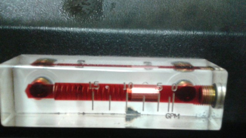

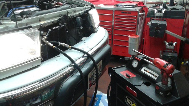

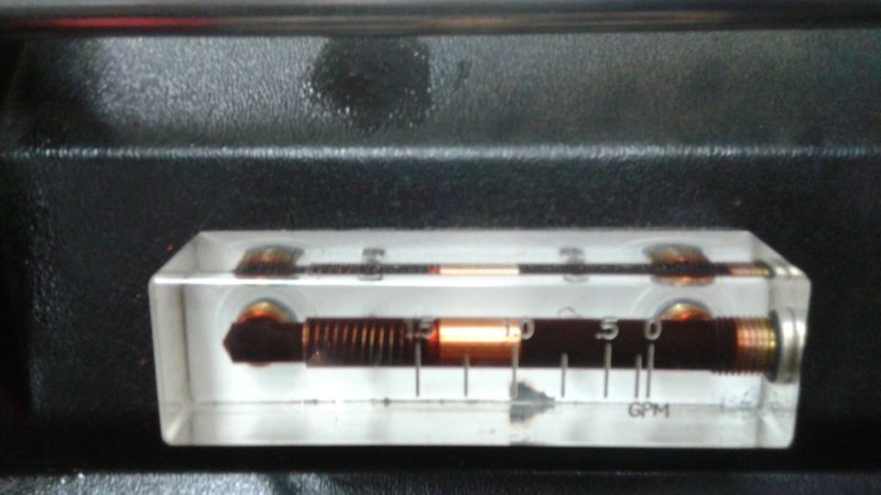

    I use the BG trans fluid machine. It's a fluid exchange not a fluid flush. The new fluid simply pushes out the old fluid. The BG machine works off the transmission's own pressure, no added pressure that could possibly cause internal trans issues. You can actually watch the fluid exchange from dark & nasty to new, see before & after pic. I've been using this machine for years on many high mileage vehicles and never a issue.
