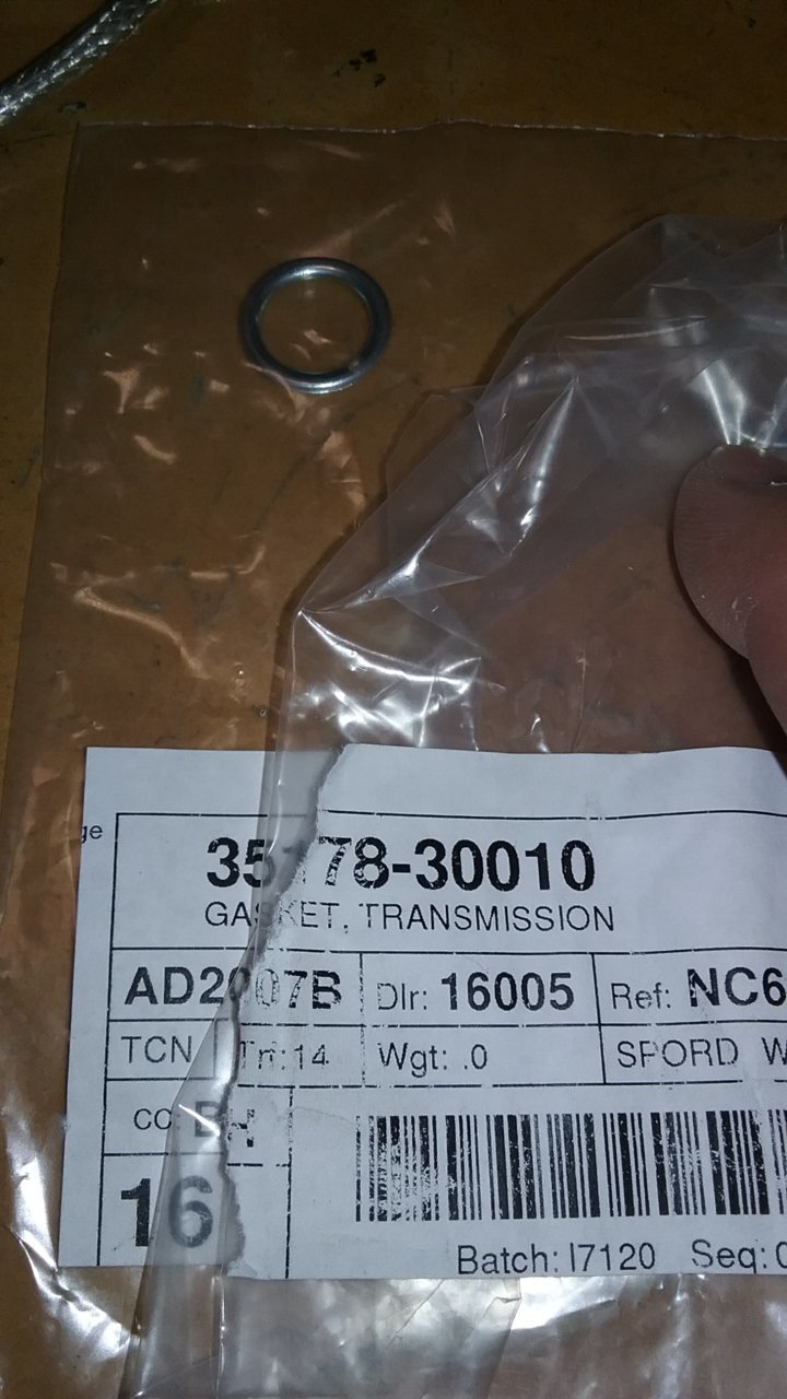

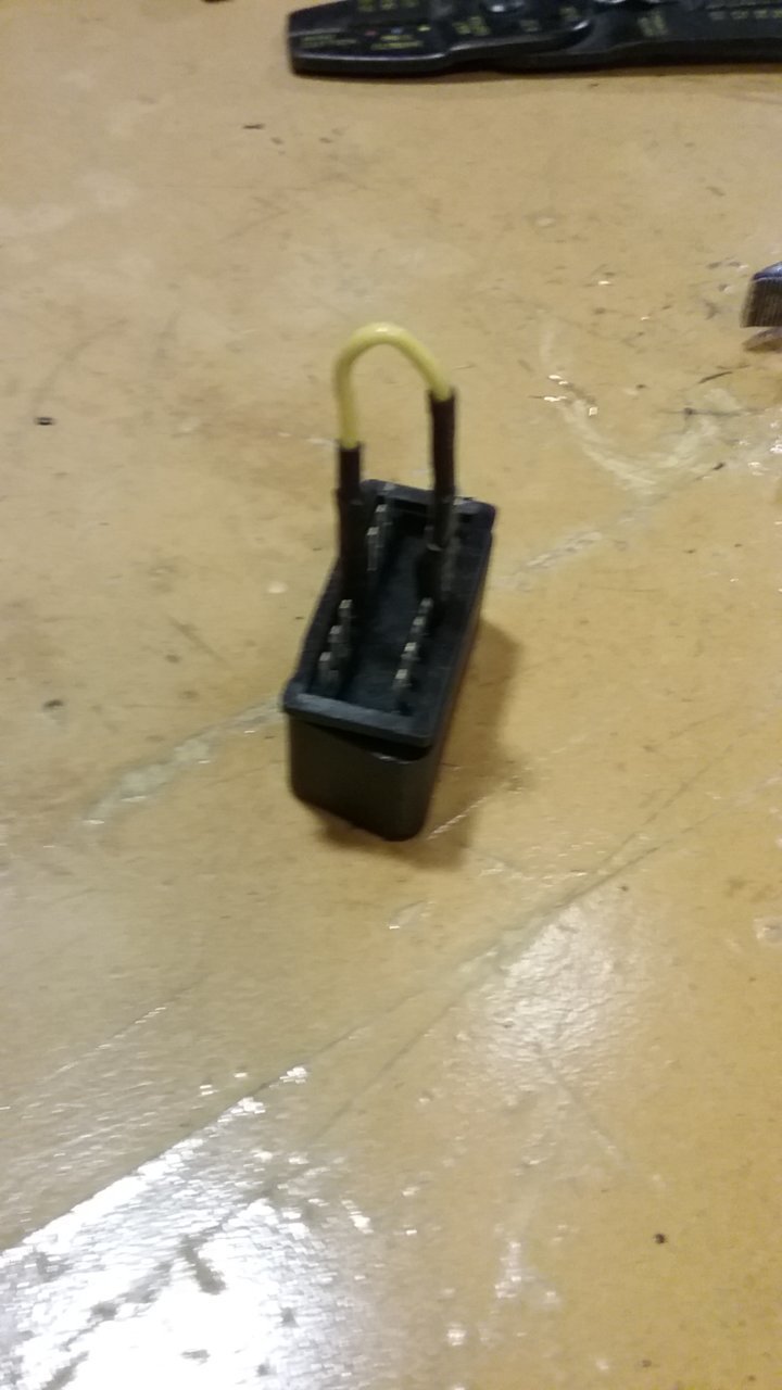

    If you're able to do an oil change....then you aren't far away from a drain and fill on the tranny.
    I purchased 12 quarts of WS from my local dealer for $7.50 each. I bought 4 drain/check plug gaskets (they're the same) for a few bucks (used 2 of them). You don't necessarily have to replace them. Lots of people don't. I didn't until the last DAF.
    At 55k miles I did 4 DAFs over the course of a couple of weeks. Every 15-20k I'll do one to help keep the fluid fresh. At around 100k or so I will drop the pan for a magnet cleaning and a new filter. I may go with Valvoline Maxlife, as it's affordable and works great in higher mileage Toyotas we have in the family.
    This is the OBDII jumper I made for easily getting into temp check mode. A wire will work just fine as well.
    Here's the gasket number. #35178-30010
    And here's the link for the how-to. Don't be afraid of this. And don't let people tell you it's a waste of time and money.
    https://www.tacomaworld.com/threads/how-to-drain-refill-automatic-transmission.63851/
