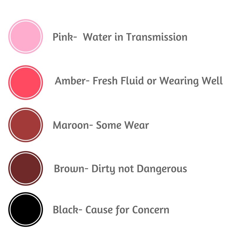

    *facepalm*
    If it's brown or black it's been overheated and burnt and needs to be replaced.
    A quick google search yielded 50 charts like this. I think you are thinking of engine oil, which is a bit different.

    Nothing? Black burnt fluid will have burned away most of the additives. Maybe not all, but certainly more than nothing.
    In 2009 or 2010, Toyota started recommending transmission flushes every 60K for Tacoma's meeting Special Operating Conditions - towing, off-roading, long idling (cabs, police use, etc ...) So, if you want a dealership to do a flush, tell them you tow and that the maintenance schedule recommends an ATF flush every 60K for vehicles that tow. (Its recommended in our 07 Lexus ES350 every 60K for towing.)
    That being said I believe you shouldn't go by mileage when deciding when to do an ATF flush. For some driving styles, 100K is fine; for others, 30K may be ideal. Short of submitting an ATF sample for analysis, the next best way to help determine when to do an ATF flush is the color chart mentioned above. As long as you don't have metal particles/flakes in the old ATF fluid, you can flush it out, regardless of mileage.
