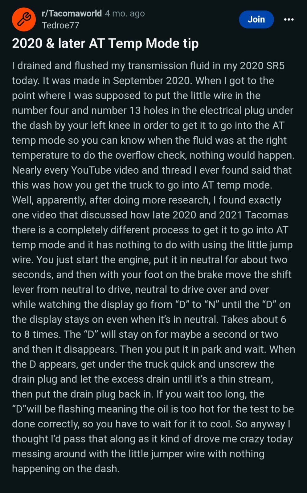

    The 2020+ can check temperature by doing a neutral drive procedure.
